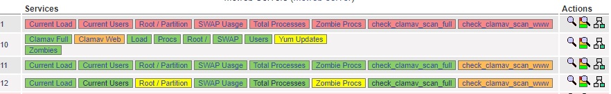

I have setup nagios core and added a bunch of checks, however i would like to keep the view as compact as possible and show all checks on one line. In the attached picture, the second line can be seen to wrap around despite there being plenty of space left for it on the same line.
-Is it possible to set it up so that "zombies" on line 2 (numbered 10, but second line down) is on the same line as the rest of the checks, just after "yum updates"?

They wrap at 8 services.
The only way to change this behavior would be to modify the source file for the status.cgi
https://github.com/NagiosEnterprises/nagioscore
