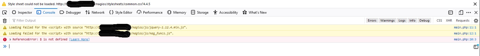

When I open the UI, my screen looks like this.
Could someone please point me to where I should be looking for the issue?

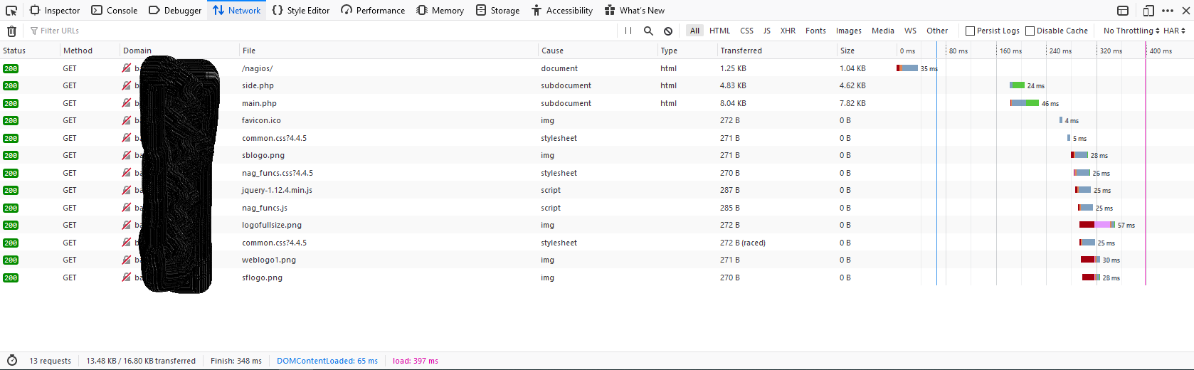

Finally, you may need to open the development tools in your browser F-12 and look at the network tab, because it looks like you aren't able to load items in the images or js directory

Results of F12, Console tab
Results of F12, Network tab
Re: Problem with UI - OpenSUSE Leap 15.1
For some reason you apache server isn't returning and results for the non-html/php portions of the page.
Has there been any modifications to the http configurations from a base install because something is catching these are not returning the proper files?
