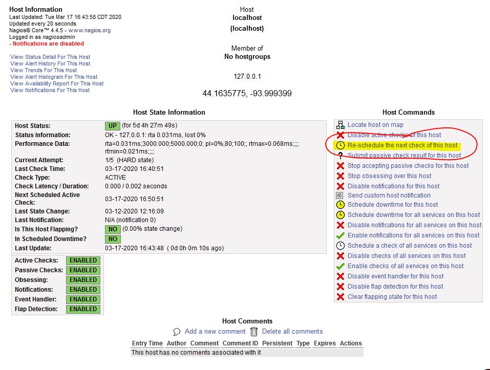

This is what a default Host detail page looks like, I circled what you would click

That is there and I did it. This did fix it they all three now say up. Do you have any idea why this happened?
Re: Nagios UI is saying something is down when it is not
Alan wrote:That is there and I did it. This did fix it they all three now say up. Do you have any idea why this happened?
If I had to guess, I think at some point the servers date was set forward and during that time these hosts performed checks.
Then when scheduling checks nagios saw the last check time was greater than the time when it needed to perform the check so it kept skipping it.
