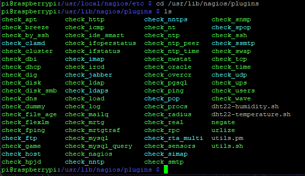

But i want so see also the stats in the webinterface,that's why i create a humidity.sh and temerature.sh with the query in usr/lib/nagios/plugins and the commands in /etc/nagios/nrpe.cfg. And at least i assigned the query to the device.

(No output on stdout) stderr: sudo: /usr/lib/nagios/plugins/dht22-temperature.sh: command not found
But i created the commands in the commands.cfg and in the plugins directory
command_name    check_hum
command_line    sudo /usr/lib/nagios/plugins/dht22-humidity.sh
command_name    check_temp
command_line    sudo /usr/lib/nagios/plugins/dht22-temperature.sh
