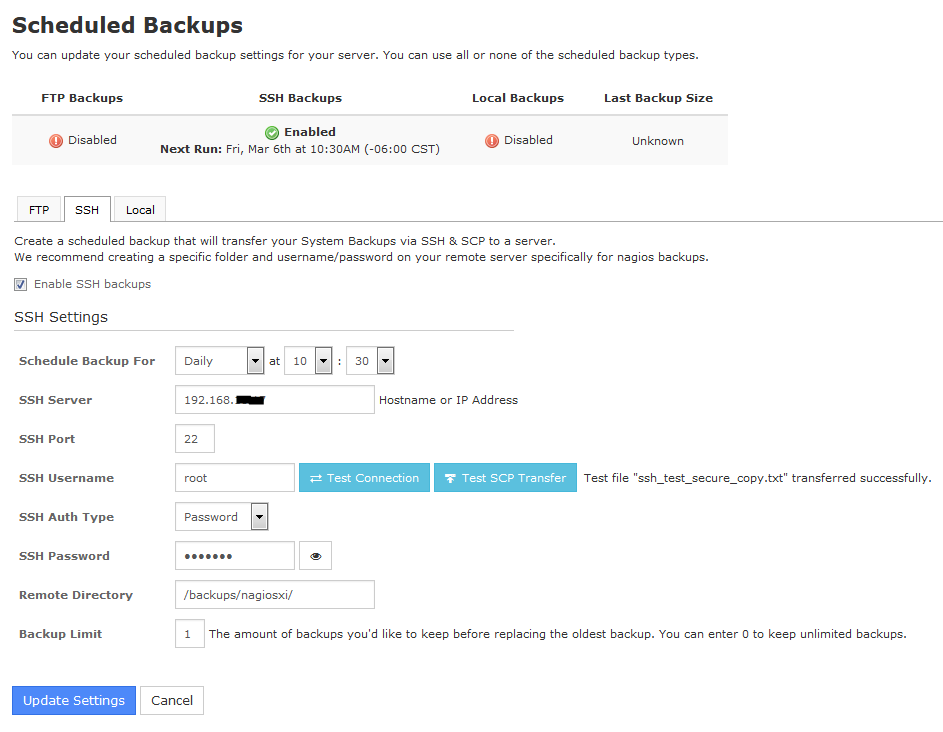

My test Nagios XI server
In the GUI Remote machine
I discussed the issue with our developers, and they believe that the problem is caused by the sshd config.
