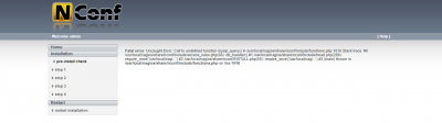

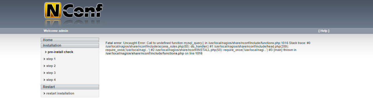

Hello and thank you very much in advance,
I have a problem in pre-install check of Nconf. I enclose the error.
Nconf pre-install check blank

Hi @Nacho,
I haven't had a chance to use this addon, but by the error message, it looks like it cannot talk to the database. Did you get the access credential set right?
If you can't get it working, Nagiosql is another option to consider.
