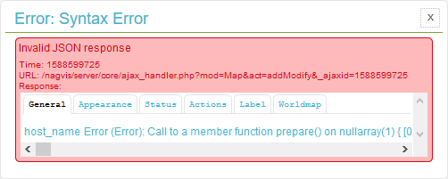

Hello guys,
I'm facing some problems when I try to get the Nagvis addon running.
System information
OS: SUSE Linux Enterprise Server 15 (4.12.14-23-default)
Nagios: Nagios Core 4.4.2
NDOutils 2.1.3
Nagvis 1.9.19
MySQL 8.0.19
My Nagios, the NDOutils broker and mysql is working fine. The database for nagvis is filled with the data from Nagios.
The Nagvis UI is also working fine. The demo functions are working correct. But when I try to add a new host from my own data (not the demo) I receive the following error:
The full error message can be found here:
log.txt
(40.62 KiB) Downloaded 140 times
Can you please provide me further steps or give me some message if you need more information.
Thanks in advance.
Best regards
Newbie

Hello everybody,
has someone some idea or next steps to find the error?
Best regards
Newbie

Re: Nagvis Error
Post by ssax »
Please post your /usr/local/nagvis/etc/nagvis.ini.php.
What does this show?
http://X.X.X.X/nagvis/frontend/nagvis-js/index.php?mod=Info
You may want to reach out to the nagvis developers on this as we do not use that version in our products.
http://www.nagvis.org/free-support
