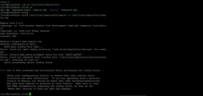

I got the following error while I was adding the router in Nagios. Please see the attachment. Can you please help me asap?
[root@localhost objects]# /usr/local/nagios/bin/nagios -v /usr/local/nagios/etc/nagios.cfg
Nagios Core 4.4.6
Last Modified: 2020-04-28
License: GPL
Reading configuration data...
Read main config file okay...
Error: Could not open config directory '/usr/local/nagios/etc/servers' for reading.
Error: Invalid max_check_attempts value for host 'RAJU-LAPTOP'
Error: Could not register host (config file '/usr/local/nagios/etc/objects/windows.cfg', starting on line 21)

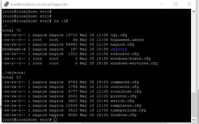

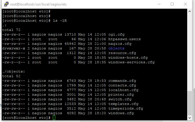

Thanks for joining the Nagios Community Forum! Looking out the output, it looks like the permissions may not be set correctly in the configurations.
Check the /usr/local/nagios/etc directory, it should look like the following:

Hi Please find the attached screenshot and let me know how to fix the permission for those files? Thanks

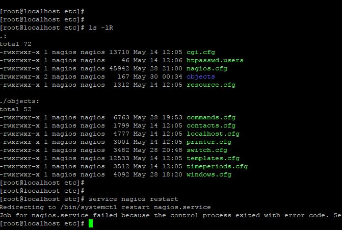

Hi @fraju,
Try running the following commands and let me know if you're still having trouble.
chown -R nagios:nagios /usr/local/nagios/etc/
chmod -R 775 /usr/local/nagios/etc/

I run your command but Still, I am getting the error...can you please check it ???

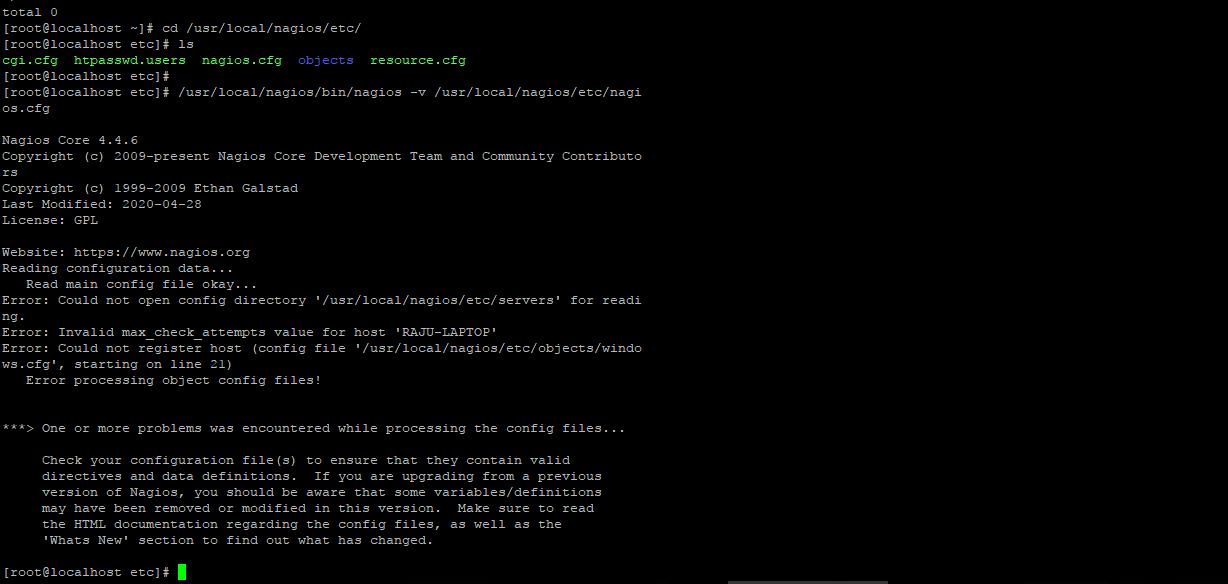

Re: please help
Could you share your /usr/local/nagios/etc/objects.windows.cfg (redacting any necessary info)?
Also, it looks like your nagios.cfg has a cfg_dir specified for /usr/local/nagios/etc/servers but the path doesn't exist
