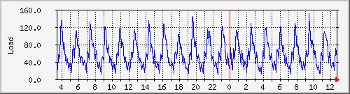

we figured out that we have regular load-spikes on our nagios server. They seem to occur every 95min but there's no cronjob running in such a shedule. We also don't have a set of checks which is just run every 95min. But nevertheless in exactly this timeperiod the load goes up.
We setup MRTG to watch this (Values are multiplied with 100):
This graph isn't showing the exact values because mrtg just takes the data every 5min but sometimes in this spike-time the load can be much higher like 3 or 4.

I think the setup has enough rescources to handle this but nevertheless we have this load-spikes.
Have you any idea what we can look at? How do we get out what each 95min is creating this load?

Do you notice anything out of the ordinary in your Nagios server logs during that spike time frame? Something to indicate that more resources would be needed?
