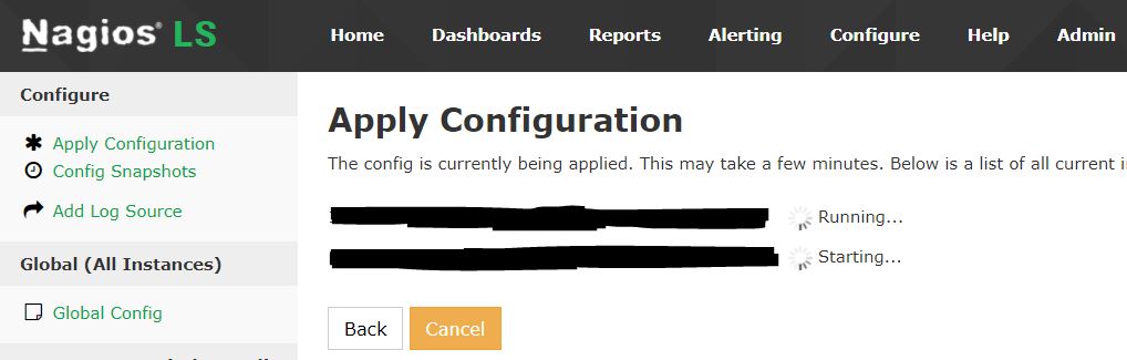

1. While performing apply configuration, it keeps on applying for longer duration 15 mins or more than that never seen it as completed.
Although after 2 3 mins I was able to see new port in configure page, so I proceeded further in adding more filters and same were reflected in configure page.

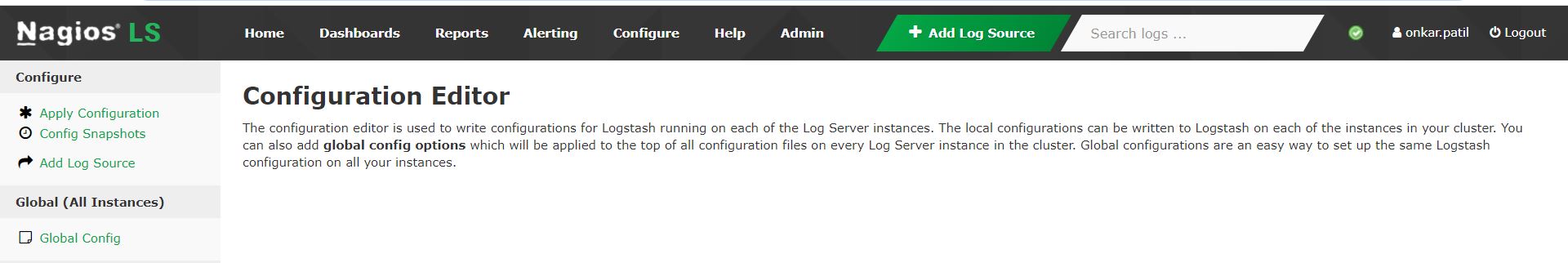

Configuration Editor
The configuration editor is used to write configurations for Logstash running on each of the Log Server instances. The local configurations can be written to Logstash on each of the instances in your cluster. You can also add global config options which will be applied to the top of all configuration files on every Log Server instance in the cluster. Global configurations are an easy way to set up the same Logstash configuration on all your instances.
Logstash is currently collecting locally on: IP tcp: ports -- This line is not shown as of now
