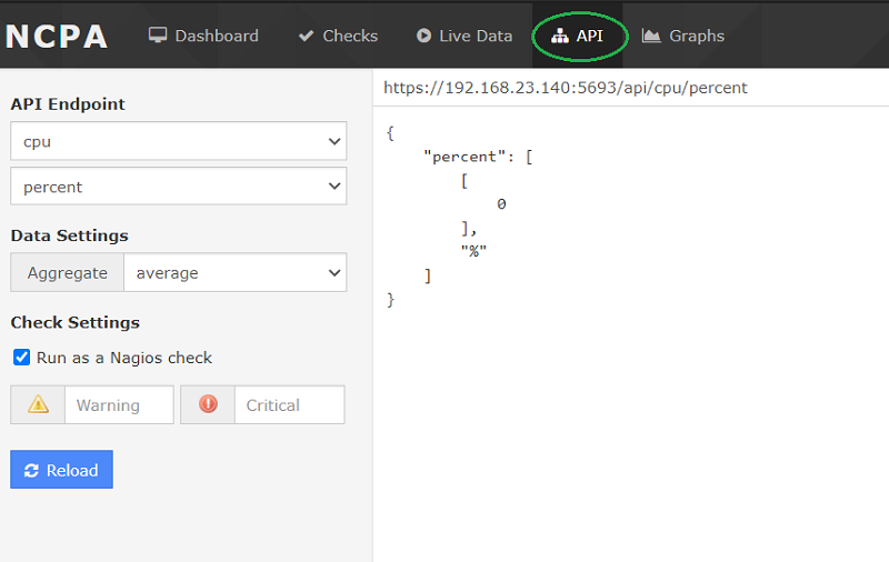

The process for setting up the checks in the configurations is really the same for any type of agent. I would definitely recommend using NCPA as we are always adding new features and it's fully supported by Nagios.
I would recommend logging into the GUI to view the built-in API. At the bottom of the page it will provide an example format using check_ncpa.py which is what you will want to use within your configurations.
