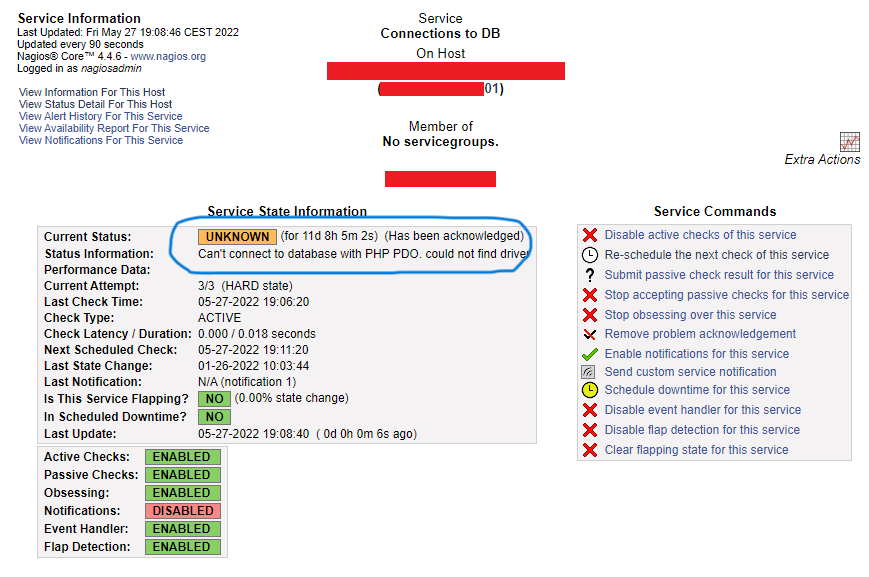

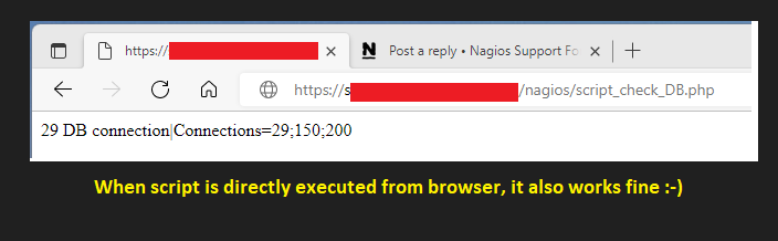

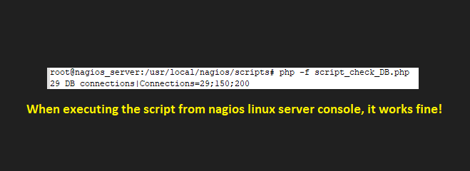

I'm posting some screenshots I have take to show what I mean is happening.
Hope it helps in someway :)
Script output when executed from browser. Working.
Script output from nagios server linux console. Working
Script output when script is executed from nagios. Not working.
