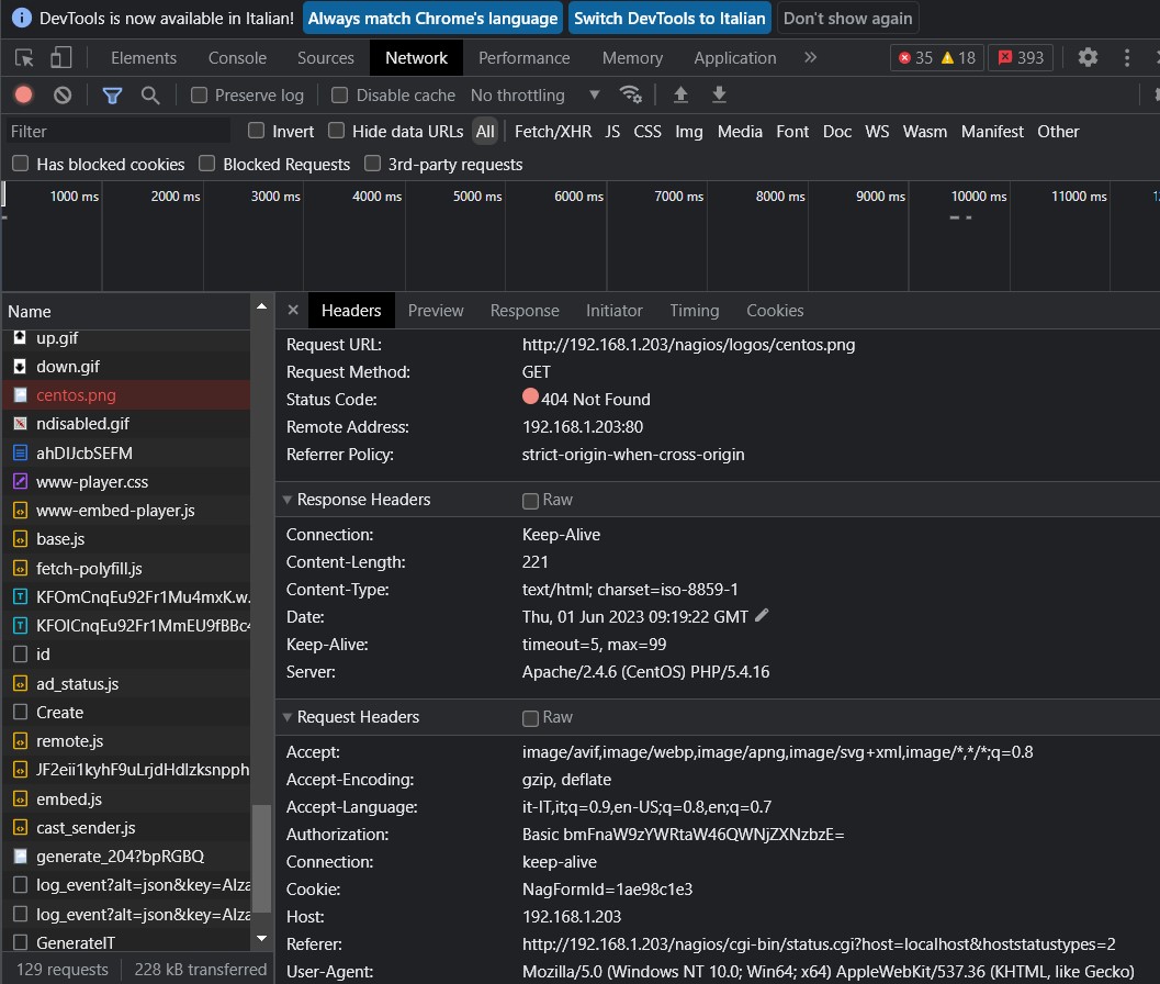

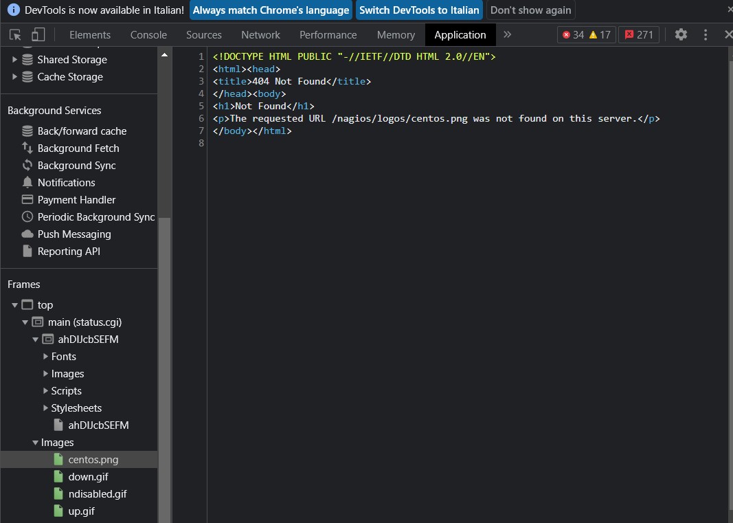

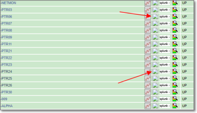

I have the same problem, i tried to install a new CentOS 7 server with new Nagios Core 4.4.12 and also in this way i have the same problem.
Trying to debug the web page with F12 you see the error messages (attached).
The other images can be seen without problems (ex: the images that can be modified by editing the index.php, main.php etc files found in /usr/local/nagios/share).
I tried with different format for logo images (.png, jpg, gif) but I always have the same problem (print attached).
Do you have any ideas?
Regards
Massimiliano

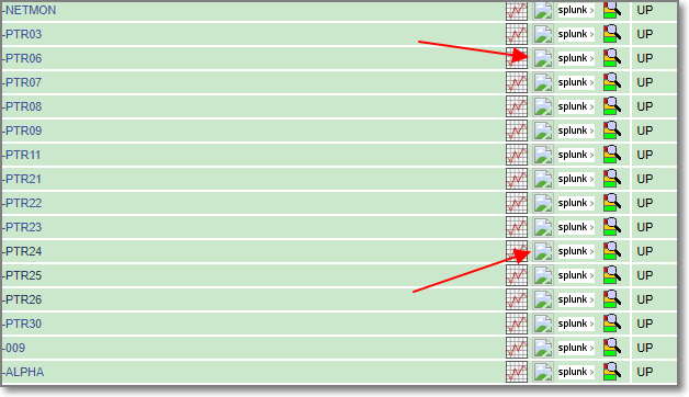

I have the same issue since applying the update. After the updating to Nagios Core Version 4.4.12, my logo icons are not appearing. They are all a generic icon symbol instead of the actual icons. Hovering over them indicate a path of https://servername/nagios/cgi-bin/extin ... devicename This was obviously caused by the update. They need to submit a fix.

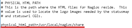

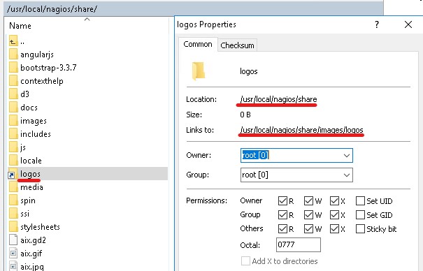

ChrisRees wrote: Thu Jun 01, 2023 12:50 pm I have done a quick and easy workaround, which was to copy the /usr/local/share/images/logos directory to /user/local/nagios/share. Then refreshed the page and all of my logos are showing up.
I also tried to use this solution and I confirm that it works, I compared the cgi.cfg files of the 2 versions of Nagios (4.4.11 and 4.4.12) and the part relating to the logos hasn't changed.
Instead of copying the folder "logos" in "share" I created a link and it seems to work this way too.

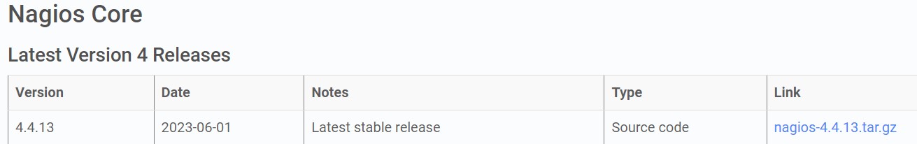

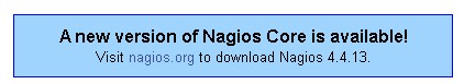

in the meantime a new version of Nagios Core has already been released (4.4.13) perhaps this has been corrected and solves some problems including that of the logos.

Thank you everyone for replying and saying they had the same issue. I thought it was just me.
Upgraded to 4.4.13 this morning and it appears to be resolved.
