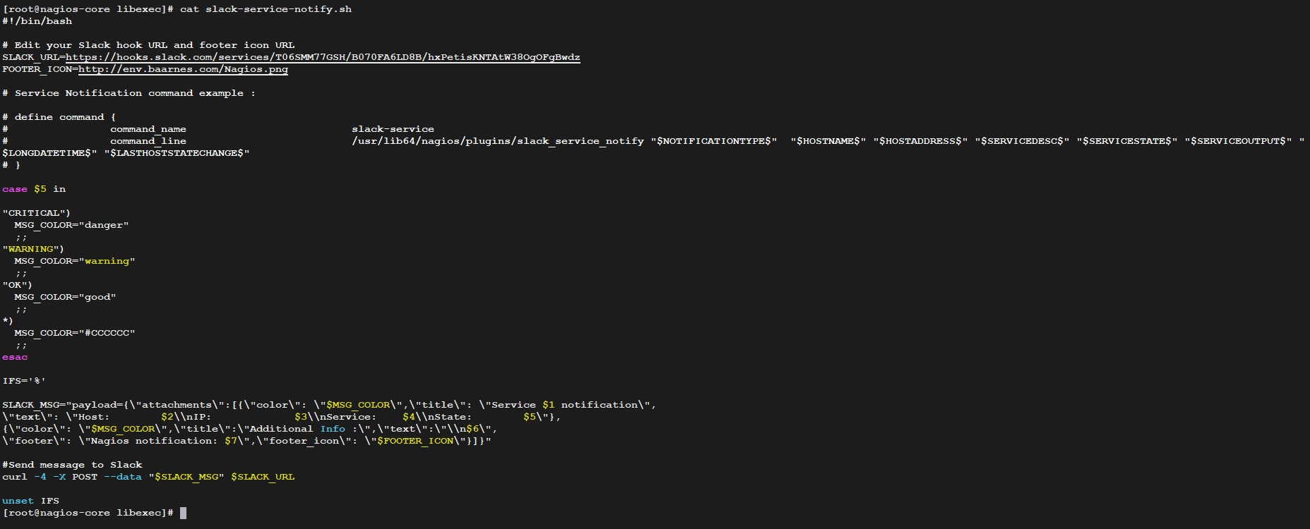

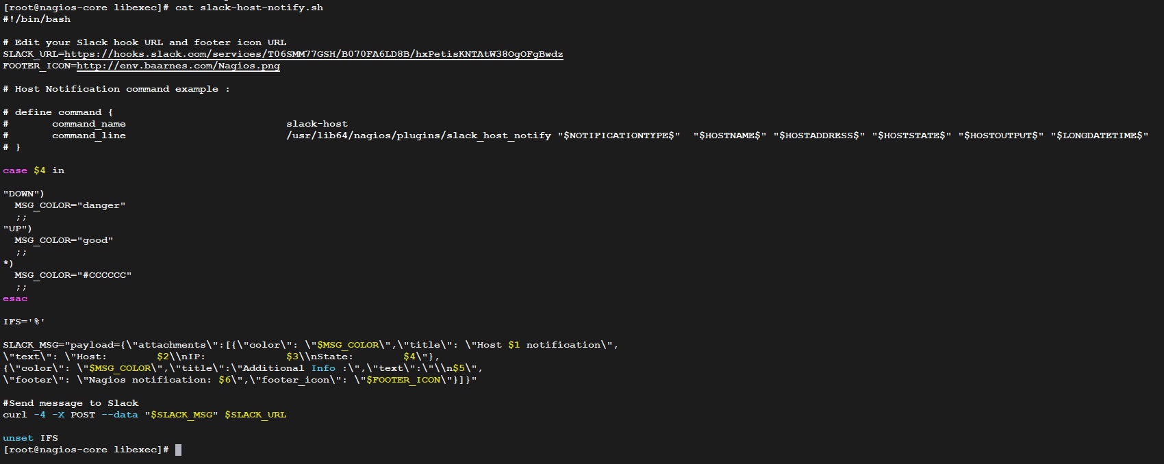

I am integrating slack with Nagios core to receive alerts and slack has a pretty simple mechanism called Incoming webhooks to achieve it. I had two separate scripts for getting slack host & service notifications under /usr/local/nagios/libexec directory. Both Nagios core & the client are RHEL EC2 instances.
On dry run for these two scripts they work perfectly, sending empty notifications to slack but actual alerts are not seen on slack. I am attaching the snip for both the files, please suggest where can I start troubleshooting for errors. I have no idea what's wrong going on here ?

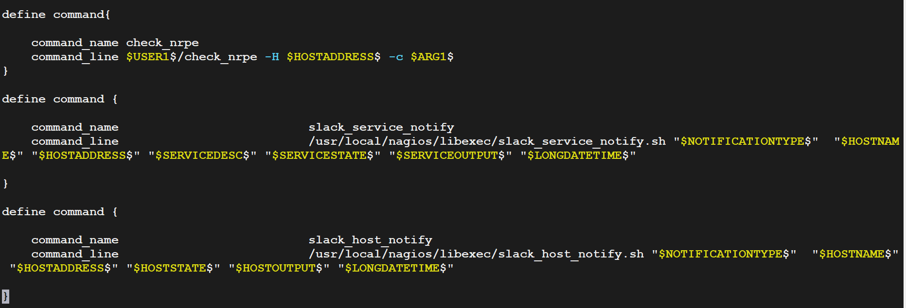

Personally, I wouldn't post your Slack Hook on a public forum. Otherwise, I would make sure the URL is executable. Also it looks like the path you put in the command is /usr/lib64/nagios/plugins/slack_service_notify but it looks like it should be /usr/lib64/nagios/plugins/slack_service_notify.sh
Let me know if this helps

Hi @danderson,
Thanks for your response, but whatever commands I defined in commands file is correct, please check the attached.
Please guide what I am doing wrong here.

Have you checked your Nagios logs? Have you configured your hosts/services to utilize your defined commands?

hi, this is resolved. One file was wrongly name which caused issue. Thanks !
