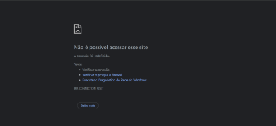

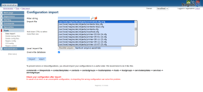

When trying to import any configuration from NAGIOS CORE the screen crashes and the file is not imported into NAGIOSQL (PHOTO1)

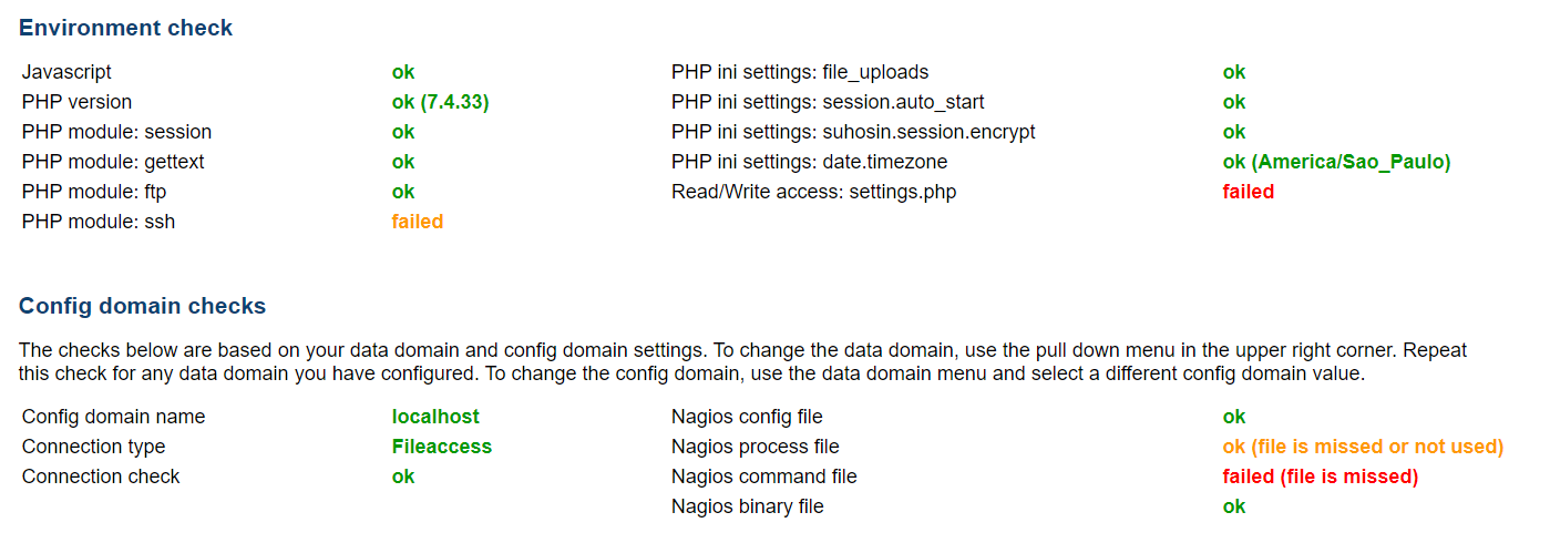

In the Administrations --> Support menu, the following errors appear, which I honestly don't know if is "normal" (PHOTO2)

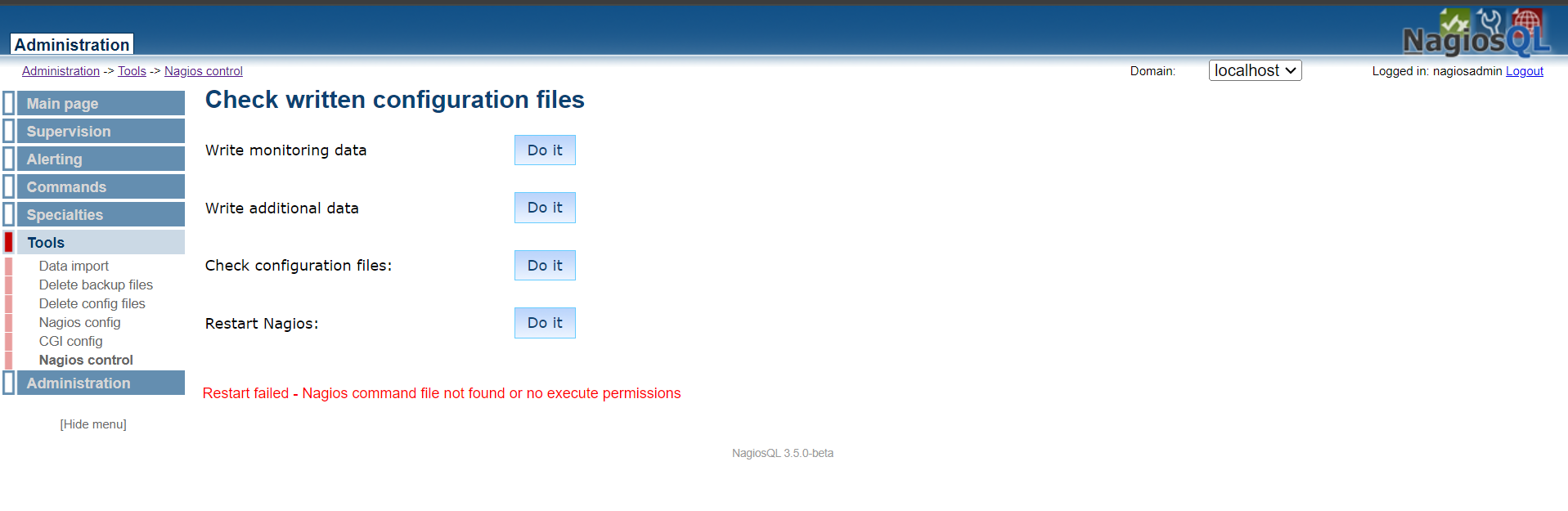

In the Tools--> Nagios Control menu, the Check configuration files buttons give the following error (PHOTO3)

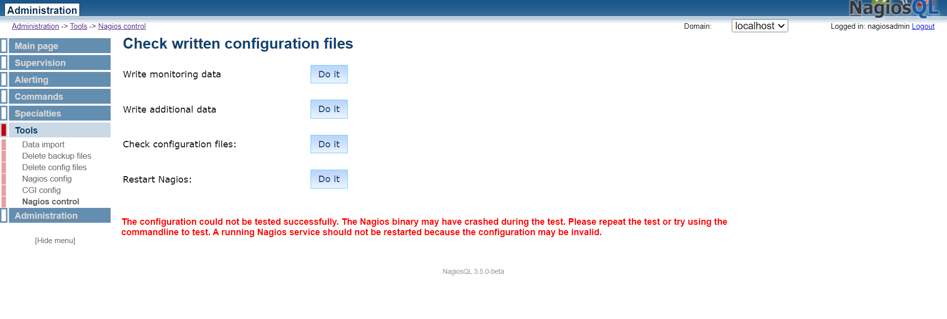

on the Restart Nagios button another error (PHOTO4).

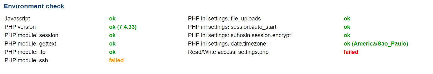

Good afternoon everyone, an update, of the 4 items with problems I managed to solve 3, which were basically a configuration of directories in administration --> Config Targets --> Modify.
However, I still have the main problem of not being able to import the files from Nagios Core to NagiosQL :(, could this be due to the read/write problem in settings.php

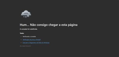

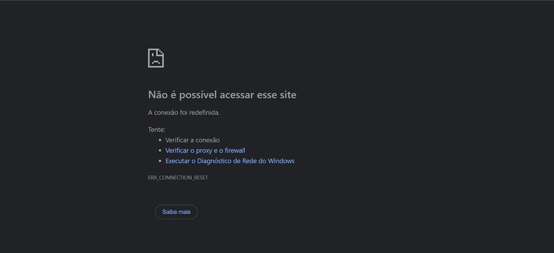

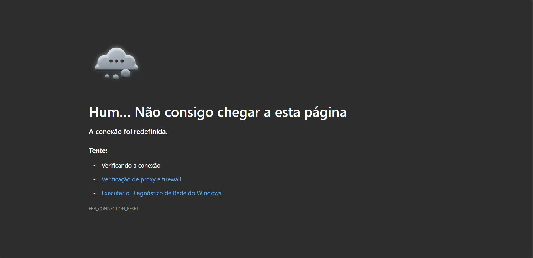

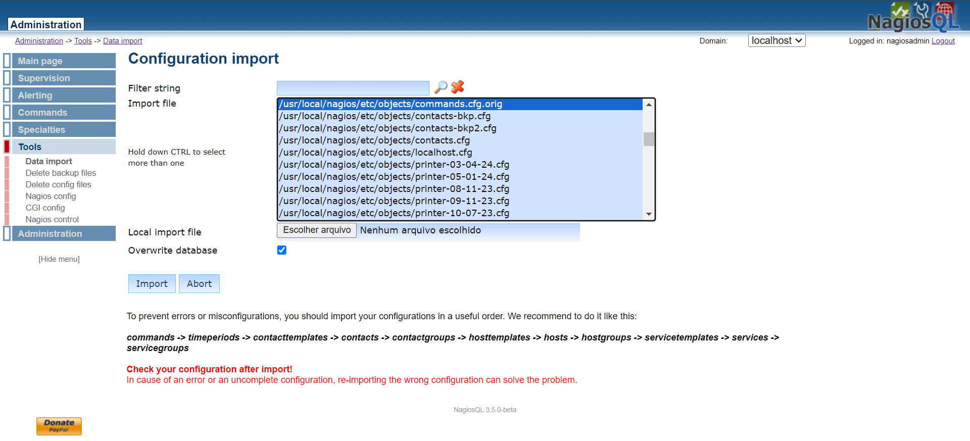

I managed to enable the configuration, I discovered that NagiosQL is in opt/nagiosql
However, I have a problem when trying to import the Nagios Core files, the problem remains, I can't import them, when the attempt is made the screen crashes and unfortunately it doesn't generate any error log, can anyone help me?
