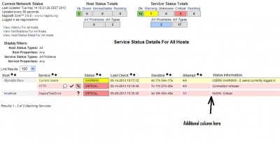

Hi!
Sorry for not replying earlier. Busy time.
I had in mind something like on attached picture, but popup with additional fields would be fine.
- Posts: 7698
Re: Alert enrichment
Currently there is no documented way to add additional columns in the Service / Host / Details Page's, though this is something highly requested. If you are interested, you can also add in a feature request at http://tracker.nagios.org
