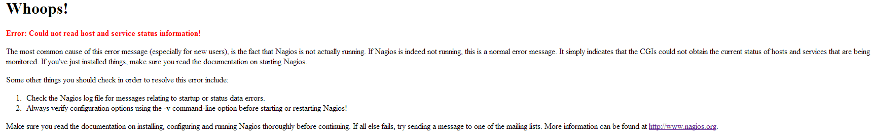

I replaced the /etc/init.d/nagios file with the reccomeded updated and when I attempted to restart nagios I received this
root@nagios downloads/nagios# /etc/init.d/nagios restart
$Stopping nagios:
$Starting nagios: /etc/init.d/nagios: 149: daemon: not found

And this is on the debian squeeze box?
mlong
Posts: 26
Joined: Mon Aug 12, 2013 12:36 pm
Re: Upgrading from 3.5.1 to 4.0.0
Post by mlong »
abrist wrote:And this is on the debian squeeze box?
Yep
and I have to say Turnkey Restore points are awesome
Posts: 13589
Try running:
apt-get install daemon
mlong
Posts: 26
Post by mlong »
lmiltchev wrote:Try running:
so after using the recommended init script and installing daemon (apt-get install daemon), I restarted the nagios process an everything looked good.
$Stopping nagios:
$Starting nagios:
Until I went to look at the Nagios web interface. it looked like the Nagios service was not running (see attachmet whoops.png)
I checked the status and got this
root@nagios downloads/nagios# service nagios status
is not running ... failed!
THis time I manually stopped an started the service using
root@nagios downloads/nagios# /etc/init.d/nagios stop
root@nagios downloads/nagios# /etc/init.d/nagios start
$Starting nagios:
This time nagios was actually running and I could see my Service status
When I rebooted I saw this:
$Starting nagios:
but when it was back up and running. Nagios seems to be working as expected.
Its kind of ugly, but it seems to have solved my issues.
