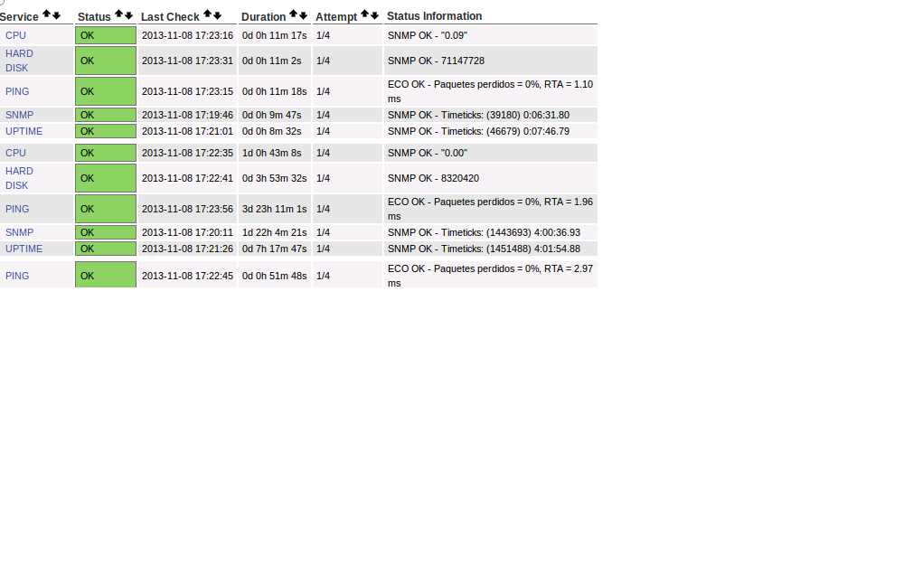

I have a problem with my NAGIOS, what happens is that this system is working perfect but the service monitor, precisely in the "status information" does not appear as I would, I would like to appear for example 30% of hard drive space and 71147728 as shown.
I'm working with 3.4.1 NAGIOS and machines have enabled SNMP monitored.
The only thing I miss is that status information appears in a more professional, more clear
This is my code:

check_snmp returns only what is reported from snmp. In your check's case, that is an integer, not a percentage. You will need to use another plugin script from the exchange, or else you will need to write a custom plugin/wrapper script.
