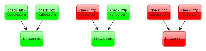

I'm looking for a simple solution to check the availability of my network connection.
What I am trying to do is something like check_http google.com
if google.com is reachable => network connection ok
if google.com is not reachable => network connection down
The Problem is that sometimes google.com itself is down :-(
My solution would be to check
if google.com and yahoo.com (two websites) are not reachable => network connection down
How can I manage such kind of correlation in Nagios? I have just found http://nagios.sourceforge.net/docs/nagi ... ncies.html
but I think this is from another perspective of view.
thanks in advance

But, I want Nagios to tell me that the Internet is down (because google and yahoo are unreachable)
I do not want Nagios to tells me that Host XY ist down because the Internet is down.
Hence I still think, that parent/child solution is not what I am searching for :-(

But then I have do correlate this checks and I don't konw how to do this with Nagios :?: :oops:
like
if www1 and www2 down then www critical
Bugs find me

You can probably use the BPI - in can be used not only in Nagios XI but also in Nagios Core...
http://assets.nagios.com/downloads/nagi ... _Addon.pdf
You can create a BPI group "Internet" with two members - google and yahoo. If both members are down, then the Internet is down...
