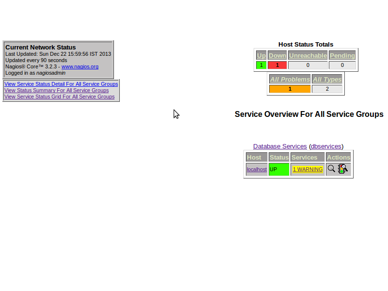

Please let me know how to get Extended Servicegroup Information. Is it implemented or not?
I have seen code extinfo.c . but i think its not implemented.
nagios/cgi-bin/extinfo.cgi?type=8&servicegroup=dbservices not showing any information.
nagios/cgi-bin/status.cgi?servicegroup=all&style=overview out put is attached in image
please help me.

Keep in mind you are using nagios 3.2.3 which was released 3 years ago, there have since been a great many updates to both security and features.
Here is a bit more info on extended info:
http://nagios.sourceforge.net/docs/3_0/ ... iceextinfo
http://nagios.sourceforge.net/docs/3_0/ ... xtinfo_cgi

Re: Extended Servicegroup Information
extinfo.cgi gives details for a specific host or service, NOT for a hostgroup or servicegroup, for them ot just gives a list of commands that can be c=executed against the hostgroup/servicegroup.
