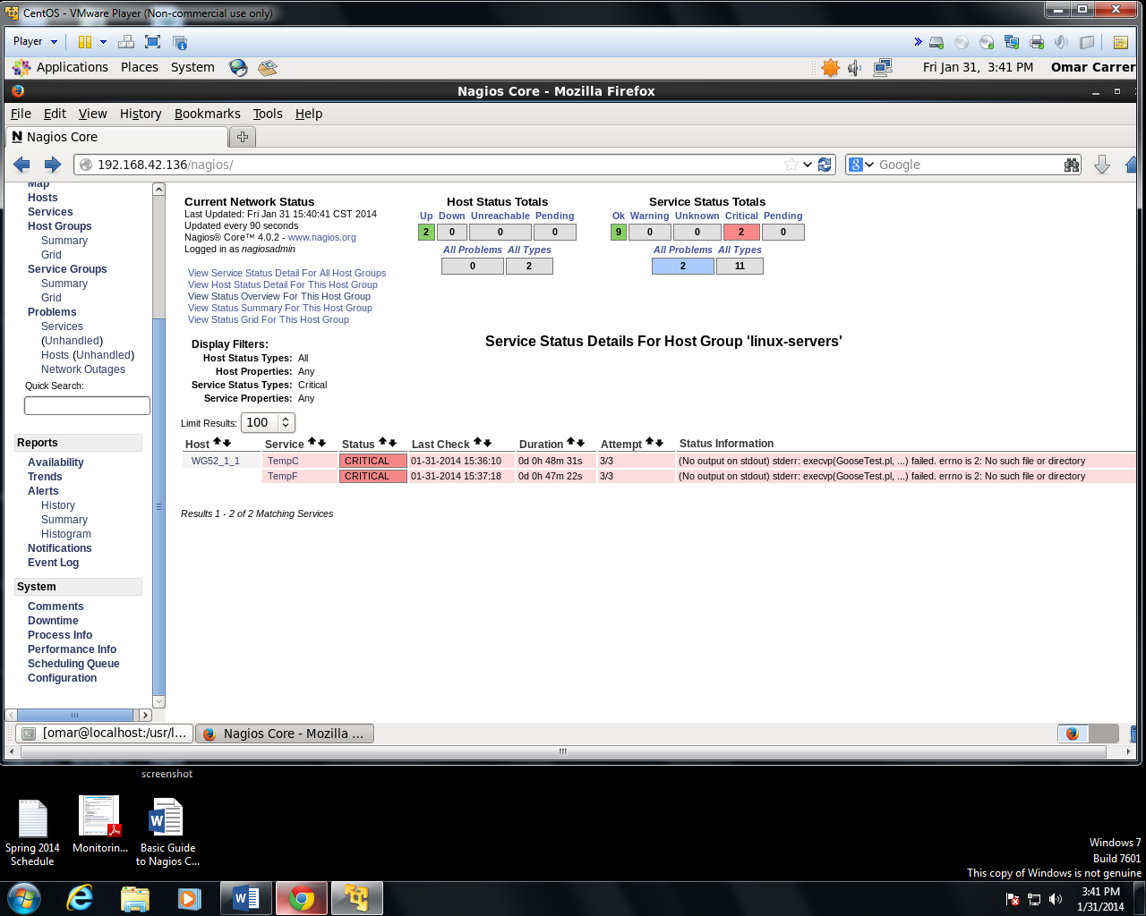

Unfortunately I get the following in Nagios
[attachment=0]Nagios screenshot2.png[/attachment]
I have been spending the last hour trying to modify the script, changing information on .cfg files , etc; that I lost track of time. I wanted to thank you for getting me this far. Thank you.

fixed issue... Turns out on the command_line on my .cfg file, I only listed the perl file and not the full directory. Afterwards I received a "Return code of 13 is out of bounds." Fixed that with a simple:
chown nagios:nagios plugin-name
chmod 751 plugin-name
once again, thanks for you help tmcdonald.
