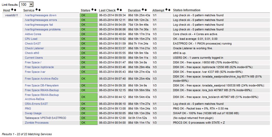

Hi folks,
there's a problem with a nagios check. All other checks have a status information except service "Tablespace VPSTAB EASTPROD". See attached jpg.
The script is defined as
command[check_east_vpstab]=/usr/local/nagios/libexec/check_tablespace.bsh -d EASTPROD -t VPSTAB -w 85 -c 90
in nrpe.cfg.
At the end of the shell script check_tablespace.bsh there are some echos and exitsatus:

How much of that output is stdout vs stderr?

Re: No output returned from plugin
Can you stick in an echo that does not sit inside an if statement? Just echo "DEBUG" or something in the first line of the script. I want to see if it can output anything at all.
The "Status Information" column in the table you showed only shows what is on the first line of output. In you example:
Running the script in CLI on the nagios server:
nagios@madpbk51:/usr/local/nagios/libexec> ./check_nrpe -H veastdb11 -c check_east_vpstab
SQL*Plus: Release 11.2.0.3.0 Production on Thu Mar 6 10:51:47 2014
Copyright (c) 1982, 2011, Oracle.  All rights reserved.
Connected to:
Oracle Database 11g Enterprise Edition Release 11.2.0.3.0 - 64bit Production
With the Partitioning, OLAP, Data Mining and Real Application Testing options
TABLESPACE_NAME         MB_USED    MB_FREE PERCENT_USED
VPSTAB                   272377      48510        82.19
SYSTEM                     1400        272        80.57
SYSAUX                     1300        298        77.06
USERS                       500        193        61.31
UNDOTBS1                   4096       4008        02.16
PSTAB                     20480      20272        01.01
6 rows selected.
Disconnected from Oracle Database 11g Enterprise Edition Release 11.2.0.3.0 - 64bit Production
Tablespace VPSTAB der Instanz EASTPROD hat noch genug Platz.
The first line is blank as seen directly under the command
This is why nothing is displayed in the table.

Hi scottwilkerson,
that looked like a very good idea. I changed my script so that I get now exactly one line of output.
[root@veastdb11 libexec]# ./check_nrpe -H localhost -c check_east_vpstab
Tablespace VPSTAB der Instanz EASTPROD muss vergroessert werden.
The check by nagios works now:
