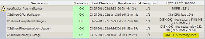

I'm using Nagios Core v3.2.0 installed in SLES10. And the Remote Client installed in RHEL.
And i found that the Monitoring of Service Status for Memory Usage in Nagios is inccorrect.
Nagios Monitoring:
Host:mypc001 OS:Linux:Memory:-:Usage:- OK: 94 % Memory used
OS Level:
But the actual memory usual in OS level is 40% Memory used
# free -m
total used free shared buffers cached
Mem: 7829 3149 4680 0 179 2074
-/+ buffers/cache: 895 6934
Swap: 10015 0 10015

Check Memory Usage 94% used
- OS Level memory used
- check memory02.JPG (15.32 KiB) Viewed 4901 times
- Nagios Monitoring Memory used
- check memory01.JPG (27.58 KiB) Viewed 4901 times

Re: Check Memory Usage 94% used
I'm not a huge shell scripter, but I'd add a few debugging checks to see what the actual values are that it's figuring. I'm guessing it's just a simple logic error.

fiRe: Check Memory Usage 94% used
Hi mGuthrie,
The result show as below:
OS:Linux:Memory:-:Usage:- Var 2 is -w
The current shell script as below:
Ok, I think I see the problem. If you can show me what you actually passed this command as an argument I could confirm it. Right now your script is asking: Is '-w' less than 2?. You probably don't need the -w or -c arguments, just pass it the integers and see if that works better.
