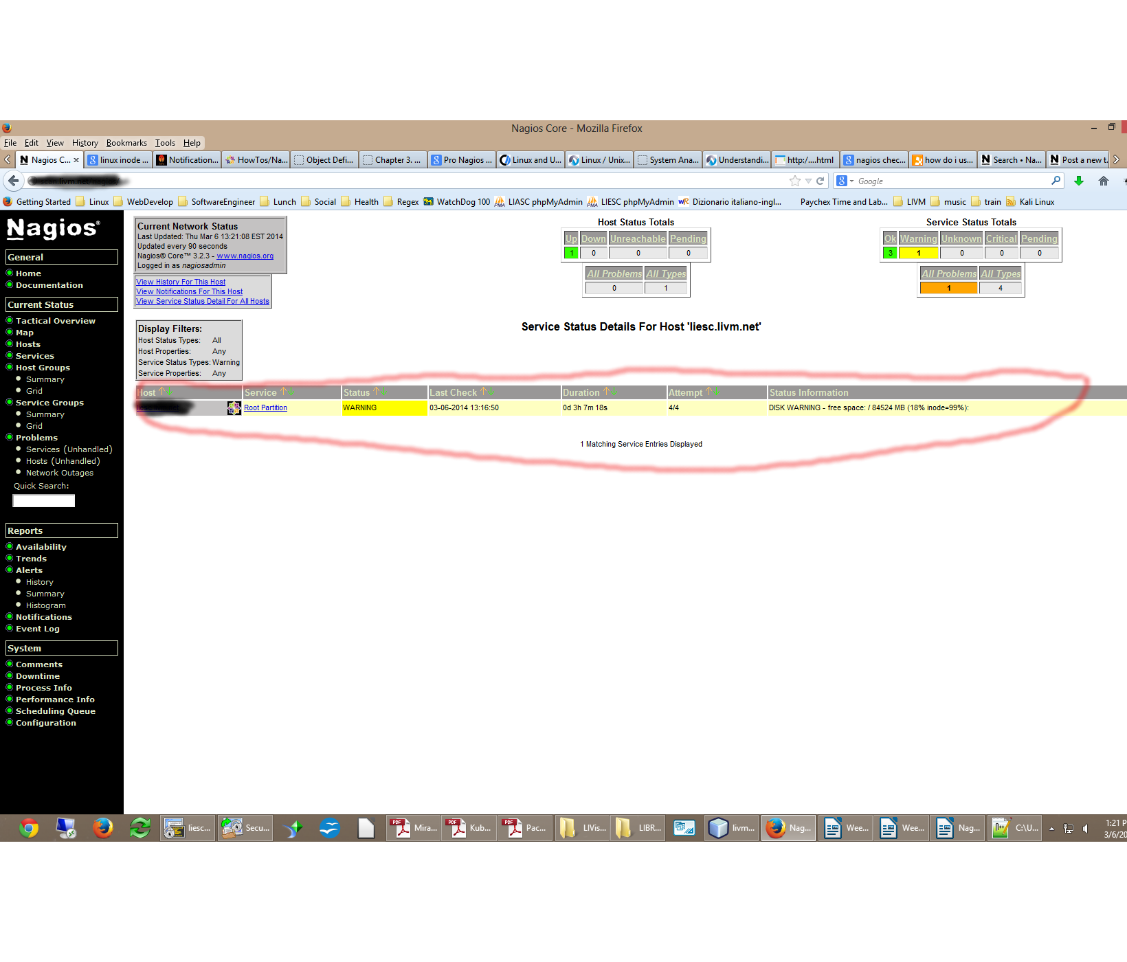

We are getting warning messages from check_local_disk when we should NOT be, as I have been checking the linux server disk usage with df -h:
[root@ourserver etc]# df -h
Filesystem Size Used Avail Use% Mounted on
/dev/mapper/vg_livm37-lv_root 11T 435G 9.8T 5% /
tmpfs 253G 0 253G 0% /dev/shm
/dev/sda1
The check_local_disk is returning warning message:
[1393909200] CURRENT SERVICE STATE: ourserver.com;Root Partition;OK;HARD;1;DISK OK - free space: / 124402 MB (26% inode=99%):
The above two do not match.

Also see attached screen shot of our Nagios GUI warning message for this server.
So what am I doing wrong in getting these warning messages when I should not be getting them?
Is there another configuration file that needs to be set?
Please help.

You are correct sreinhardt!!! I just checked the local system warning message (less than 20% disk space) matches when I run df -h on the local machine! Well this is not our intention. We want monitor all the remote servers listed in the host_name field of the minimal.cfg file, here is the define service we have for the remote servers we want to monitor (see attached for the complete minimal.cfg):
