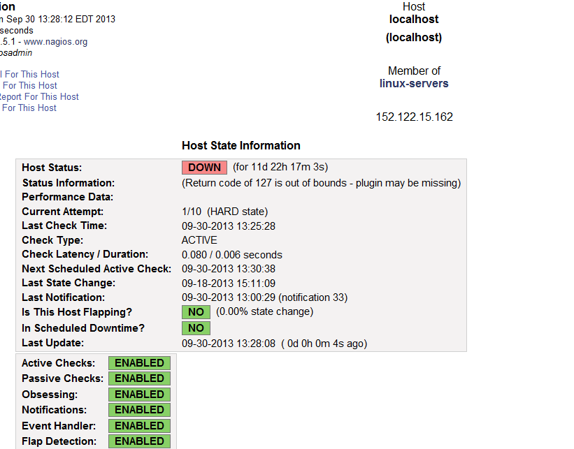

What is the exact error you are receiving from that host in the web interface? Is it something along the lines of 100% packet loss? OR, is it something else? Please copy it here, and also a copy of your localhost.cfg, is it only your localhost and switch that are showing down? Are these your only hosts? If not, let us know, this could be a problem with the plugin or some odd configuration change / blockage that is just coming to light.

looks like its missing a plugin...screen shot attached..
