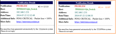

Yes, I'll show you a print of both notifications:
Re: double notifications
Are you receiving double notifications for all host/service issues or just certain ones? If it is just a select few, can you let us know of any possible connections or patterns between them? I am still leaning toward duplicate config options somewhere.

I believe this issue was related to having more than one instance of nagios running at the time.tmcdonald wrote:Are you receiving double notifications for all host/service issues or just certain ones? If it is just a select few, can you let us know of any possible connections or patterns between them? I am still leaning toward duplicate config options somewhere.
Could this be it?

Absolutely, this would cause this problem.sebastiaopburnay wrote:I believe this issue was related to having more than one instance of nagios running at the time.tmcdonald wrote:Are you receiving double notifications for all host/service issues or just certain ones? If it is just a select few, can you let us know of any possible connections or patterns between them? I am still leaning toward duplicate config options somewhere.
Could this be it?
