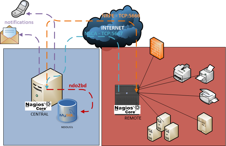

I have a distributed Nagios infrastructure pictured in the attached picture.
My Central Nagios' Server (v 3.3.1) is sending double notifications for some events.

My infrastructure scheme
