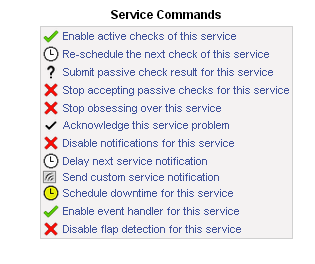

These are the service commands available to me in that helps?

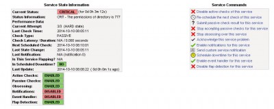

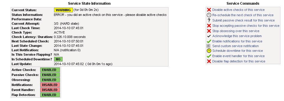

That seems to work although I'm not sure I understand what's going on now.
After clicking enable active checks, I see this screen asking to disable active checks:
But later if I go back to the service, it seems fine, although it reports this as an active check (which it isn't):
The console now displays an unhandled message which seems right :

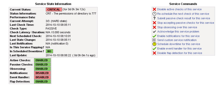

Posted: Fri Oct 10, 2014 4:17 pm
by equick
No it reverts back to disabled like this one:
