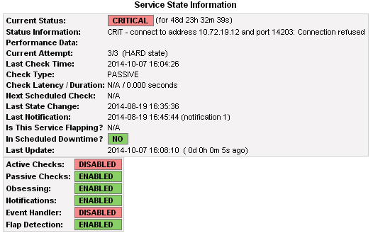

equick wrote: If the notifications are enabled for a service, should nagios still add the disabled label on there?
What disabled flag are you referring to?
The only disabled flags I see are for event handlers and active checks. Not notifications.

The Disabled label in the blue box:

I'm having trouble replicating this here.
When you click x disabled it should list all the objects that match the criteria defining it as disabled.
