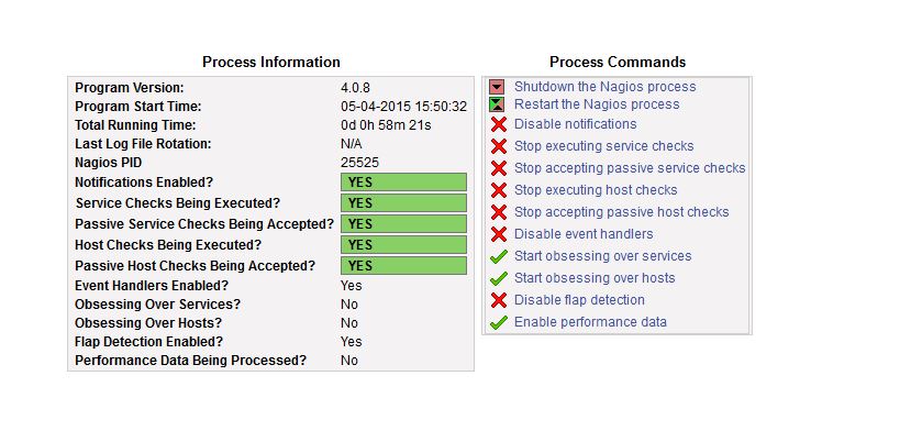

jdalrymple wrote:I assume based upon the error that this happens when you are trying to get to the schedule downtime page?
What are the results of http://myserver/nagios/cgi-bin/extinfo.cgi
How about http://myserver/nagios/cgi-bin/cmd.cgi
I expect both of those to work fine based upon what you've shared so far. Would you care to gzip up your cgis and send them my way? Unless you did any mad customization (which would no doubt be the source - no pun intended - of your problem) there should be no sensitive information. I'd love to just drop them on my 6.6 machine and see if they CGIs work properly here.
I've attached the screen shot of the extinfo.cgi command. The cmd.cgi out just says "Error: No command was specified"
I would be glad to pass along the cgis. This system is a IBM Power 8 (ppc64). Let me know if that will work for you first.
