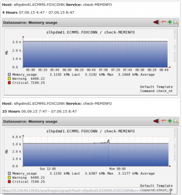

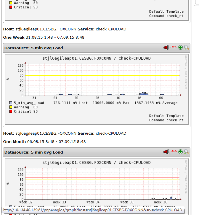

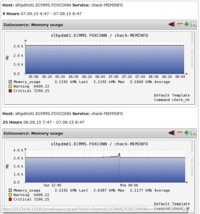

I install rrdtool+pnp4nagios on nagios server.
Then the picture 28 , 29 show the photo of the cpu , memory status.

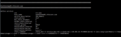

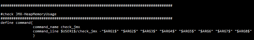

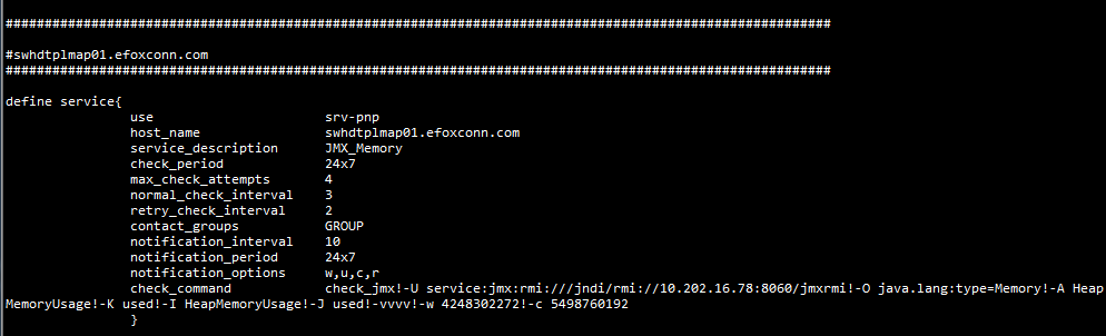

The picture 42 show the command.cfg
The picture 43 show the services.cfg
The picture 44 show the status of the JMX ,the status of JMX is unknown .
What 's the wrong with the problem ?
How can I solve this problem?

Re: How can I use the check_tomcat script to monitor ?
In your command definition, remove the - sign in front of "$ARG1$"
When I remove the - sign in front of "$ARG1$" .
The picture show the error.
- 48.png (8.81 KiB) Viewed 3433 times
- Box293
- Too Basu
- Posts: 5126
Your $ARG6$ does not end with a $ sign, it is $ARG6 but should be $ARG6$
Thanks very much for box293,it's OK now.Please see the picture 54.
The JMX Memory show the HeapMemoryUsage of the Tomcat.

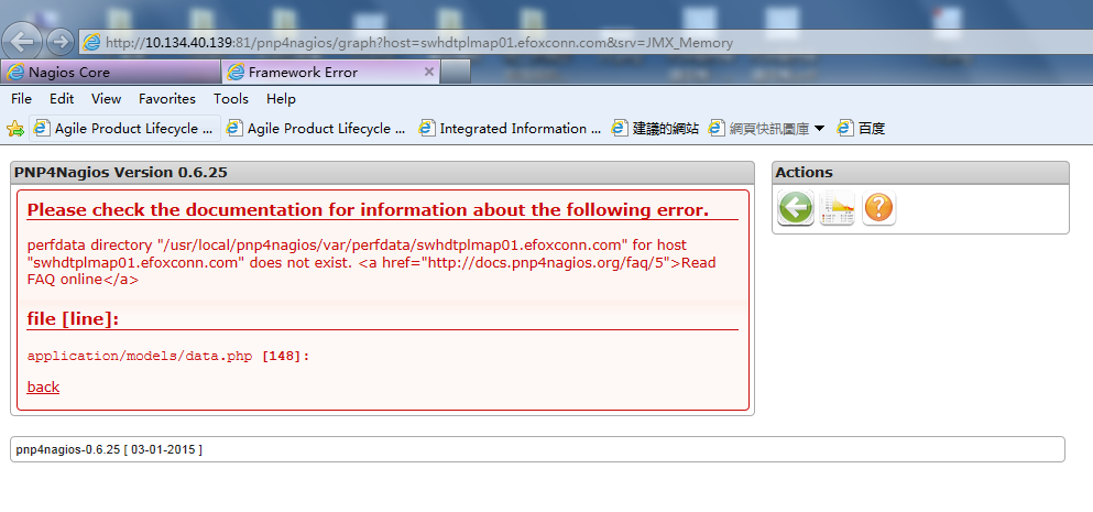

But the question when I click the button of .Please see the picture 55.
The picture 56 show the error information.
How can I solve this problem ?

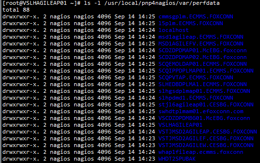

Does that directory exist? If so, what are the permissions?
ls -l /usr/local/pnp4nagios/var/perfdata
The picture 13 show the result of execute "ls -l "
It show there is not the host "swhdtplmap01.efoxconn.com" name in /usr/local/pnp4nagios/var/perfdata
So what should I do can solve this problem ?
