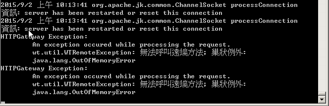

The Tomcat windows report error:"java.lang.out of memory"
I want to use Nagios monitor the error , Please tell me the method.

The tomcat report error:
java.lang.OutOfMemoryError: Java heap space

A screenshot would really help, it lets us see where you are seeing the message.

The picture show the tomcat out of memory
Tomcat Out of Memory.png (8.44 KiB) Viewed 4024 times

Which scipt should I use can monitor the out of memory ?

You could try using JMX:
https://exchange.nagios.org/directory/P ... mx/details
This guide is for Nagios XI but the concepts are similar:
