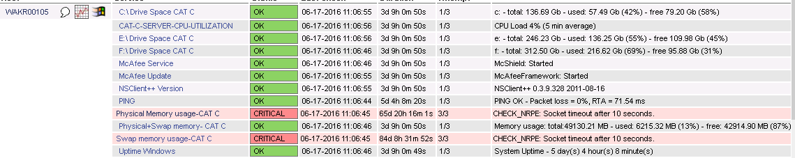

screenshot from nagios tool

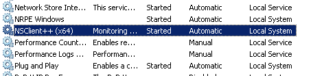

Re: Check_nrpe socket time out after 10 seconds for windows
Post by rohithroki »
yes i have only one nsclient instance running on the server. Attaching the SS
If you stop that service from running using net stop nscp, and then run netstat -an | findstr 5666 what is the output?
