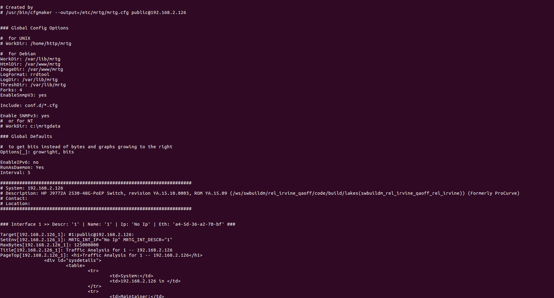

Thank you so much for all your help.
I added what you sent to the mrtg.cfg and attached a picture to make sure that was correct.
When I tried to use the cfgmaker to make the swtichip.cfg I was informed I don't have a /etc/mrtg/conf.d/ directory.
Thanks again for all your help.
