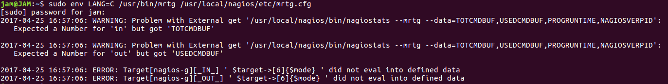

Thanks for the quick response. I was following that guide earlier and got to the
env LANG=C /usr/bin/mrtg /usr/local/nagios/etc/mrtg.cfg
and it gave me an error attached.
Thanks!

what are the contents of the file you're running against mrtg? my guess is there may be an issue with it.

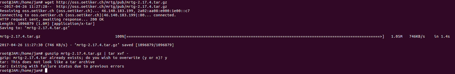

I was following that first guide before and was unable to successfully complete it.
gunzip -c mrtg-2.16.2.tar.gz | tar xvf -
cd mrtg-2.16.2
was the part that it wouldn't do for me.

Re: check_mrtgtraf
What was the error generated when you tried to go through the guide?

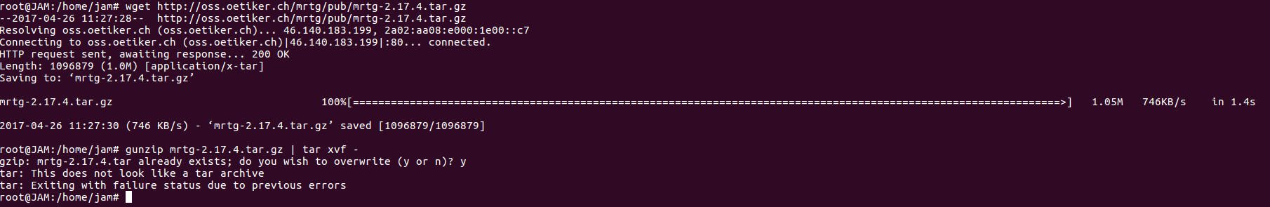

This is the error I get.
Re: check_mrtgtraf
Run this command to extract MRTG tar zip file instead of the gunzip command.
tar xvfz mrtg-2.17.4.tar.gz
