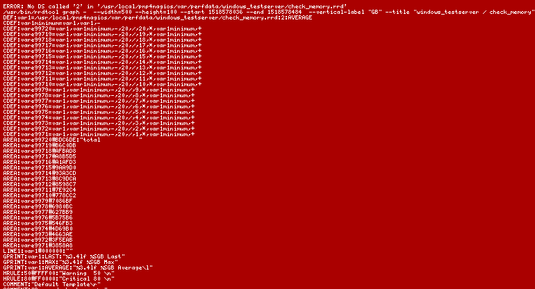

I think we are using pnp4nagios to get the performance Graph of the each host.The page is redirected to the path as given below and the service using is Host Perfdata.
http://10.211.31.191/pnp4nagios/graph?h ... testserver
Please find the error while checking the memory ,disk.
Thanks in advance.
Thanks for the reply.
Thanks in advance.
Re: How can we monitor pnp4nagios and integrated with NCPA?
This seems like an error with how PNP4Nagios is interpreting this host's performance data. Which is ... odd.
Strictly speaking though, this is a PNP4Nagios problem. Not a Nagios Core or NCPA problem.

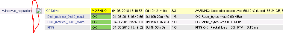

Hello Experts,
could you please clarify the missing options.
I have installed NCPA agent on the client side and monitored via nagios server.
From nagios server side, I seen that one option is missed out (Perform Extra actions ) nearby hostname. Attaching the screenshot1
while I seen the options ,when the nsclient++ installed and monitored via nagios server . Attaching the screenshot 2
The option will be redirected to another web page 192.168.xx.x/pnp4nagios//index.php/graph?host=hostname to monitor the performance graph of client.
but we manually able to see the performance graph via NCPA agent.
why the option is not visible while monitoring the ncpa client?
Is there any possibility for changing the source code ?
You know... I think I see what you mean now. Sorry I didn't catch it sooner.
You can add that graph option using the Extended host information. (NOTE: it will be deprecated in a future version)
https://assets.nagios.com/downloads/nag ... ostextinfo
To accomplish this, I would look at your cfg file for BDNFS6
Then find what you have for extended host information there, and change it for NCPA. You will also need to use the correct URL in order to view the graphs.
You can also post your BDNFS6.cfg file for us to review.
/usr/local/nagios/etc/objects/BDNFS6.cfgYou can also post your BDNFS6.cfg file for us to review.

Hello rohithroki,
On the host defnition used with NCPA you did not specify the Windows host template, that is the line starting with ‘use ...’.
