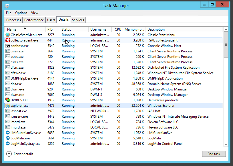

@mhedtcke, Can you open the Windows Task Manager on the 92.168.39.40 server and take a screenshot of the processes tab so that we can see the explorer.exe? I wonder if the process is called differently on your system, maybe like explorer64.exe?

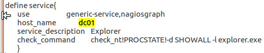

Your comment about case triggered an idea for me. "Explorer.exe" in the windows config file was uppercase and "explorer.exe" is lowercase on my server. I changed the windows.cfg file to match with it being lower case but it still alerts even with the case matching in the updated config file.
