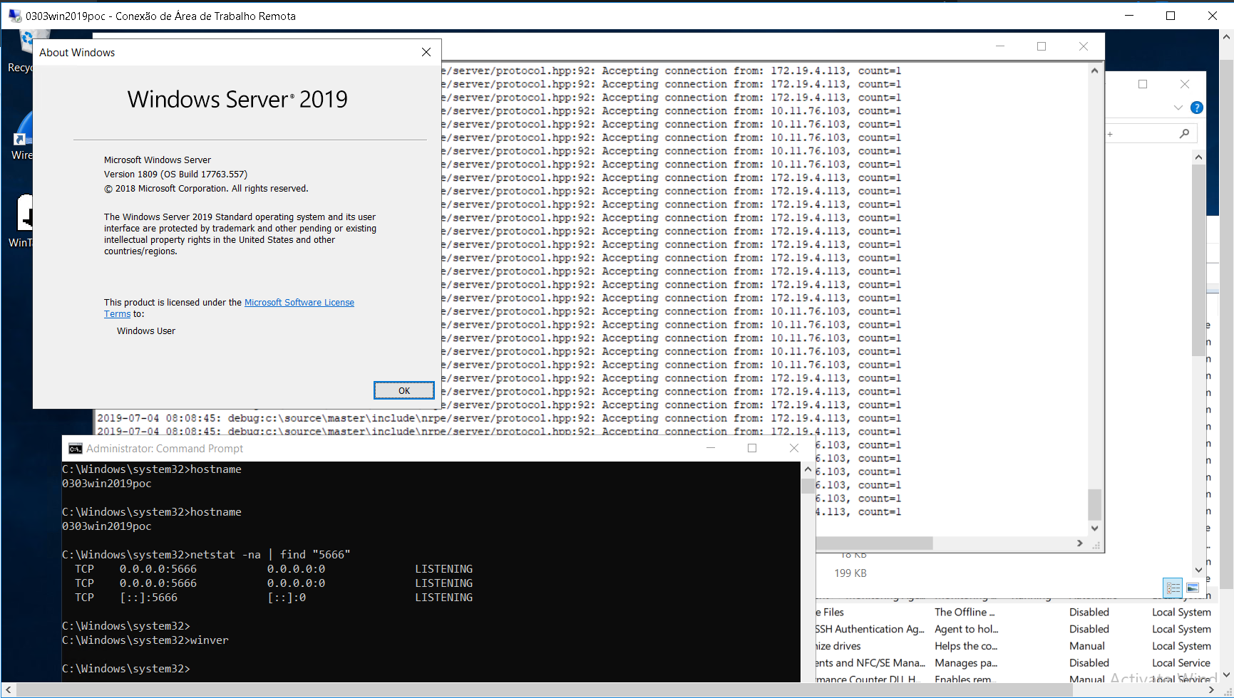

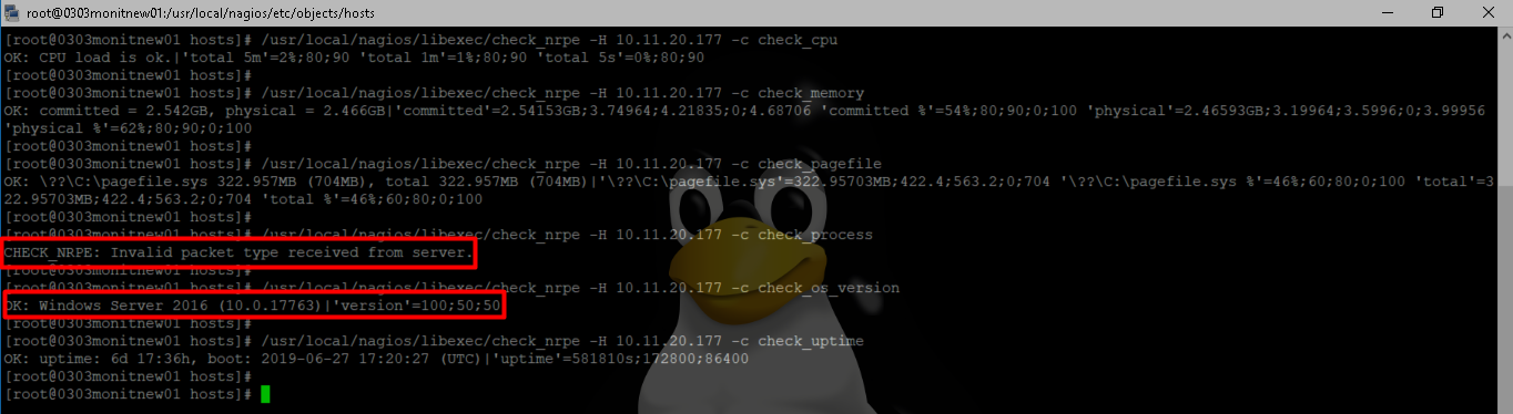

Greetings tgriep,
I performed the tests on both servers (Nagios 4.4.2 and 3.5), the results were the same (annex).
I highlighted two buggy returns, the version of OS (identified as Windows Server 2016, but it is Windows Server 2019) and process verification.
Attached is the host configuration file.
Thanks a lot for your help.
Best regards,
Kohlbach

The check_process example need to have an argument specified with the name of the process you want to test.
For example, to test the print spooler, you would add this.
-a process=spoolsv.exe show-all
Add a process to that command.
The configs that you posted did not have how the command is defined.
Post the check_nrpe_action command so we can view it.
Also, the $ARG1$ in the checks has an "ox" defined, what is that?
Remove it and see if that fixes the issue.
