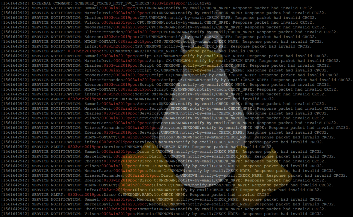

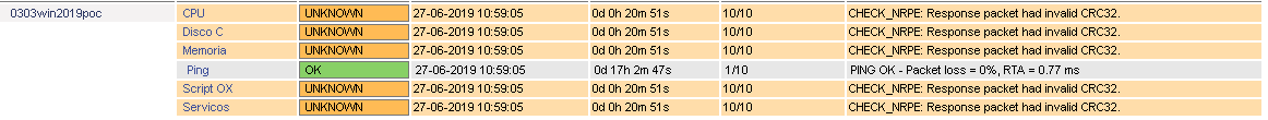

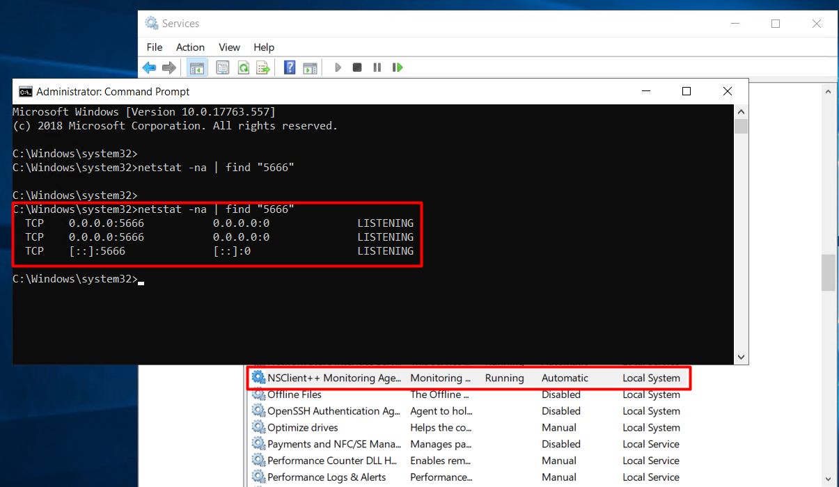

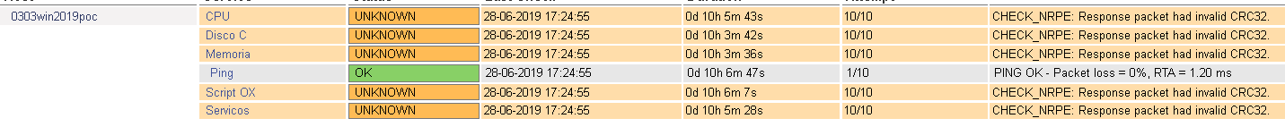

Greetings,
We have 2 servers running Nagios, version 3.5.0 and version 4.4.2. There are currently hundreds of servers monitored, with Linux, Unix and Windows.
We installed in Windows 2019 the version of NSClient 0.5.2.35, however, it returns the error "CHECK_NRPE: Response packet had invalid CRC32" in both versions of Nagios.
Does anyone know how to handle this error?
ps: follows attachments
Thank you,
Kohlbach

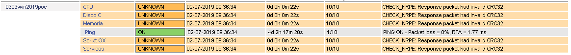

Re: CHECK_NRPE: Response packet had invalid CRC32
Hi tgriep,
Many thanks for the feedback.
I have made changes, but the error continues.
follow attach the files.
Best regards,
Kohlbach.
Best regards,
Kohlbach.

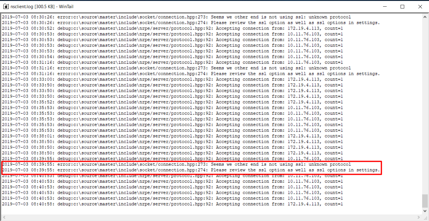

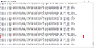

The nagios.log file was empty so that did not help at all.
Add this to the nsclient.ini file to enable trace level logging.
Restart the agent, let the checks run and post the nsclient.log file.
[/settings/log]
; LOG LEVEL - Log level to use. Available levels are error,warning,info,debug,trace
level = trace
; FILENAME - The file to write log data to. Set this to none to disable log to file.
file name = nsclient.log
; DATEMASK - The size of the buffer to use when getting messages this affects the speed and maximum size of messages you can recieve.
date format = %Y-%m-%d %H:%M:%S
[/settings/log/file]
; MAXIMUM FILE SIZE - When file size reaches this it will be truncated to 50% if set to 0 (default) truncation will be disabled
max size = 2048000Be sure to check out our Knowledgebase for helpful articles and solutions!
Follows the attached file.
Thank you for your help.

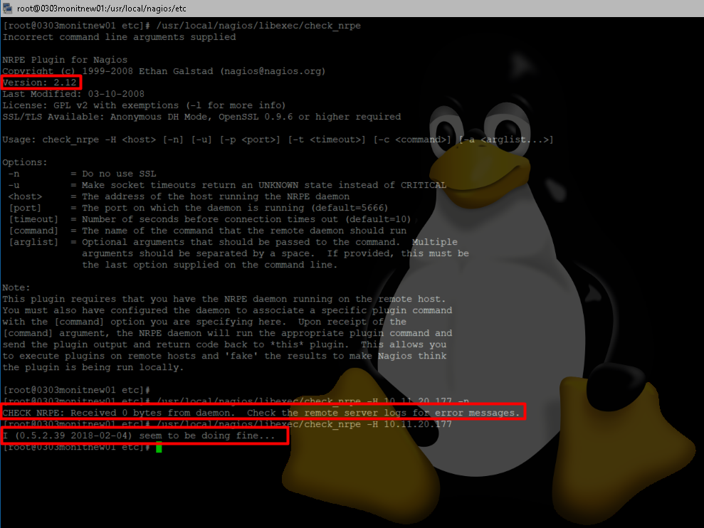

Run this on the nagios server so we can see what version of the check_nrpe plugin you are using. It may be that you are using an older plugin that is causing the issue with the newer NSClient++.
Then to test the connectivity to the Windows server, run the next commands and post the output. Change the xxx.xxx.xxx.xxx to the IP address of the Windows Host.
If you like, try upgrading the check_nrpe plugin and the following link are the instructions for doing that. Search it for this string "Install check_nrpe Plugin Only" for the instructions.
https://support.nagios.com/kb/article.php?id=515
/usr/local/nagios/libexec/check_nrpeCode: Select all
/usr/local/nagios/libexec/check_nrpe -H xxx.xxx.xxx.xxx
/usr/local/nagios/libexec/check_nrpe -H xxx.xxx.xxx.xxx -nhttps://support.nagios.com/kb/article.php?id=515
Greetings tgriep,
Attached are the results of the requested commands.
Updating the nrpe is complicated, because currently we are with hundreds of servers (around 650) running 3 OS with different versions, only this is where the problem happens.
When you ran the check_nrpe test with only the IP address, it connected to the NSClient agent and returned the version number so it is working.
What we have to do now is to look at how the command and the service checks are defined in the Nagios config files.
There may be an option that is causing the issue so can you post the check_nrpe command and the service checks?
Another quick test you can try is to run the following command to run a memory test against that host to see if it responds.
