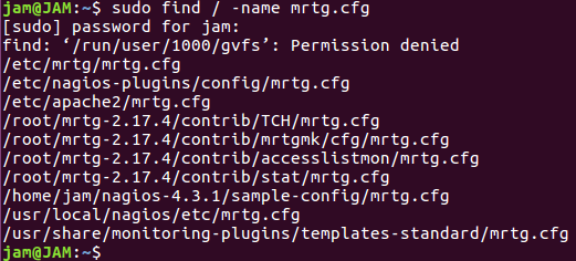

What's the output of find / -name mrtg.cfg?
You may just need to run mkdir /etc/mrtg/conf.d/ but if you have multiple configs, that might not be all that needs to happen.

Yeah it looks like I don't have that /conf.d/ folder. Here are my results.
Any advice is appreciated!
