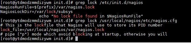

Can you show the output of the following
grep lock /etc/init.d/nagios
grep lock /usr/local/nagios/etc/nagios.cfg

Either way, they are just going to show is it the lock file location is the same in both locations like it should be

please find the output of the commands in the below attached attachment .
Thanks .

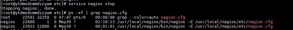

Re: automatic creation of pids
Do you get any errors when you stop nagios?
service nagios stop
After the stop is complete does this still show processes?
ps -ef|grep nagios.cfg

No i donot find any issues while stopping Nagios and yes even after stopping Nagios after running the command ps -ef | grep Nagios .cfg some processes can stiil be seen as running .
please find the attachment .
Processes running when Nagios service is in on state is 16 and after stopping it is 8 when it should be 0 .sometimes processes running is more than 8 .
