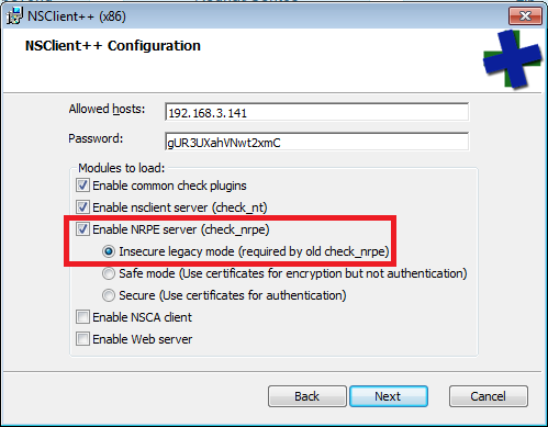

Re: Check_nrpe socket time out after 10 seconds for windows
On the latest 0.4.x version, the option is "Insecure legacy mode"

I tried uninstalling and reinstalling the Nsclient by selecting the Insecure legacy mode. Still i'm facing the same issue.
I have attached the screenshot and the Nsclient configuration file for your reference.
Thank you so much for your response.
