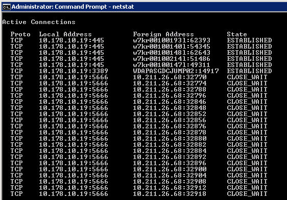

2. All 3 servers have an extended amount of “CLOSE_WAIT” port 5666 connection status
3. All 3 servers exhibit the same NRPE error in the Windows event logs

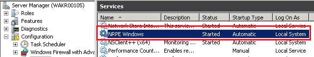

Finally found that all the 3 ClearCase servers are running their own copy of NRPE for Windows which is taking over the NRPE config/port for NSClient++ on these servers.
When we tested by stopping this particular service.. It worked

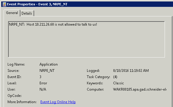

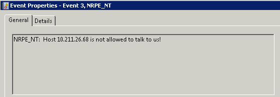

But my question here is NRPE windows is working on port 5667 and the NRPE port configured in NSC.ini file is 5666. Then why there is an overlap??

Port 5667 is used in NSClient++ for passive checks (NSCA).But my question here is NRPE windows is working on port 5667 and the NRPE port configured in NSC.ini file is 5666. Then why there is an overlap??
