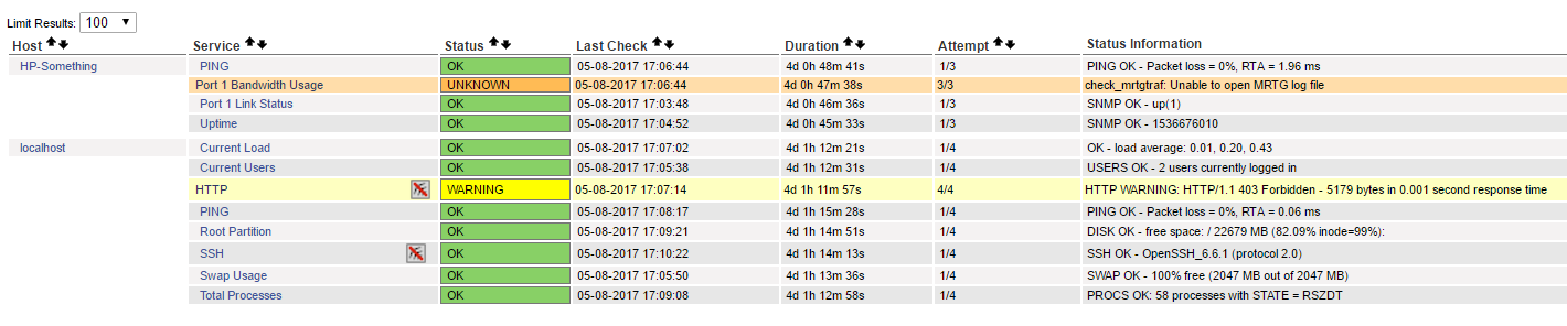

What is telling you it's unable to open the mrtg log file?
Show the command you are running to generate the error.

On Nagios itself. Picture attached.

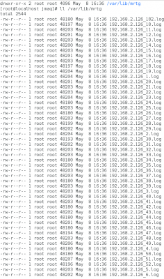

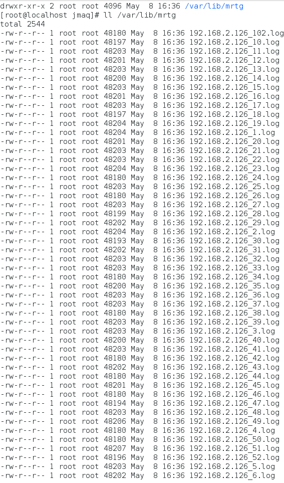

ll -d /var/lib/mrtg? If off centos now then you should use ls instead of ll.
Also, the output of ll without the -d. Both sets are important. The nagios user needs to have read access, so you want to see some r for read in the output.
jmac727
Posts: 35
Joined: Tue Apr 25, 2017 4:37 pm
Re: check_mrtgtraf
Post by jmac727 »
The results of that:
Posts: 4583
Re: check_mrtgtraf
Post by dwhitfield »
Probably the directory is also owned by root, even though we didn't get the ll -d output.

Post by jmac727 »
The ll-d output was the very first line in the picture. I did the chown and still no dice.
