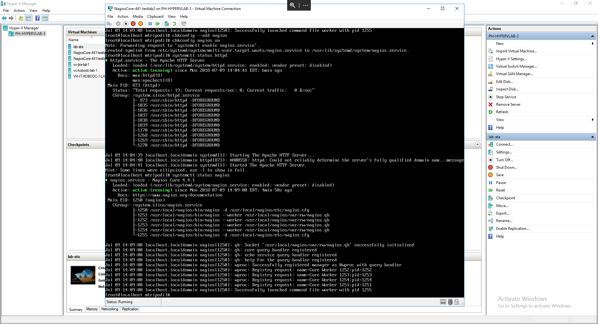

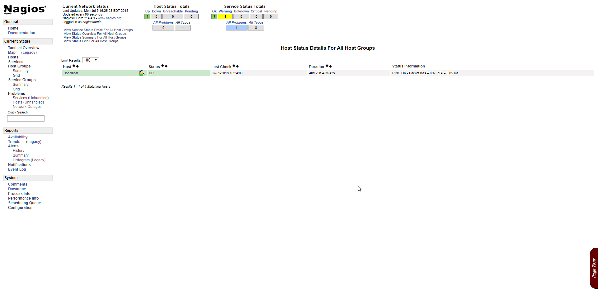

I disabled the firewall, noticed Nagios wasn't started automatically after reboot so I ran a command to set that. Confirmed both Nagios and httpd service are currently running. See attached imaged.
I can reach the test page when entering 172.19.1.7 with the /nagios at the end.

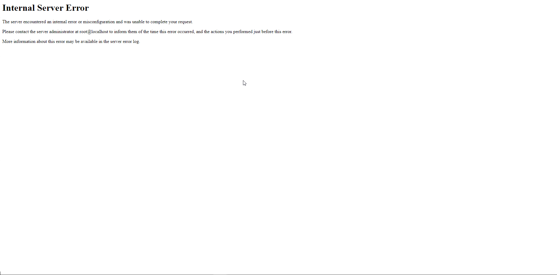

It was working initially, I ran through some of the configuration I copied over and resolved the errors. Once they were all corrected, I tried hitting the webpage again and ran into that message.

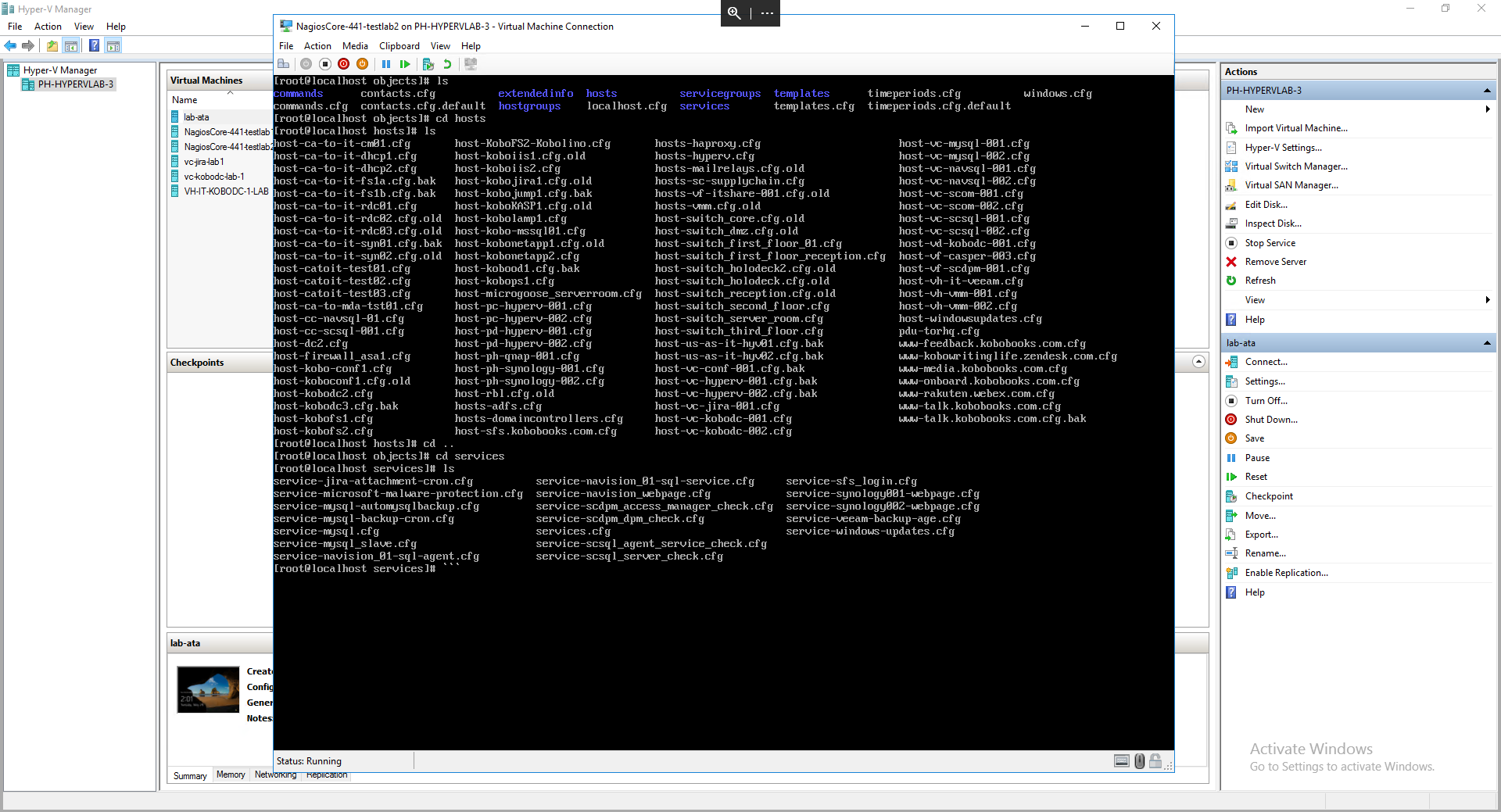

Ok I figured out that one on my own as well. The htpasswd.users and cgi.cfg files were moved and not in the /usr/local/nagios/etc/ directory. The last part preventing me from proceeding with testing is that I have no hosts or services listed, even though I copied my existing configuration from our production server to the test one. They are currently in the following directories on the test VM:
Root folder: /usr/local/nagios/etc/objects/
Hosts: /usr/local/nagios/etc/objects/hosts/
Services: /usr/local/nagios/etc/objects/services

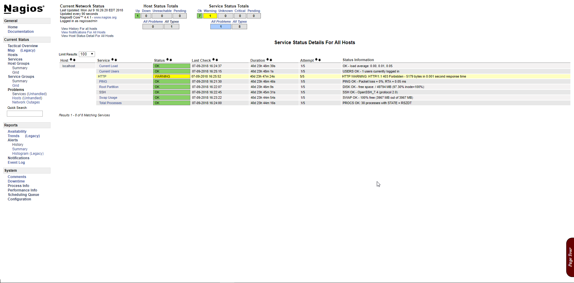

I attached screenshots of what I see in the web interface and how the directory structure looks on my test server. I renamed some of the files that came with the 4.4.1 installation to .default so I can use my existing files instead for the new server.
Please let me know if there are conflicts in the files, in the wrong directories or if I didn't perform the step process correctly. I would like to have the web interface reflect the current hosts and service checks we have in place so I can test receiving an output from service check and notifications. Thanks!

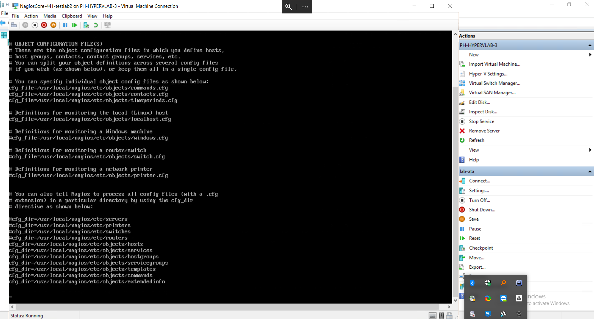

if you look in the nagios.cfg that is being used, it will have paths to both files and folder that need to be included, you need to make sure that your new setup is looking at the correct full paths.mtripodi wrote:The last part preventing me from proceeding with testing is that I have no hosts or services listed, even though I copied my existing configuration from our production server to the test one.

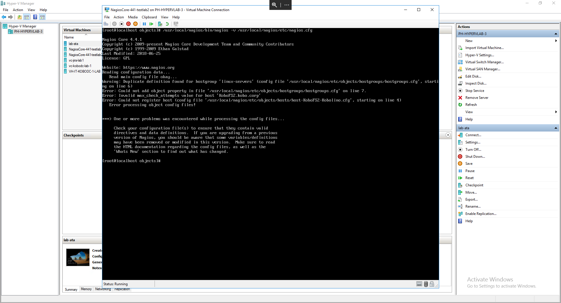

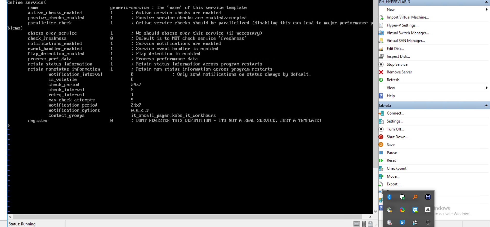

I was able to edit the nagios.cfg file by adding the directories containing the configuration I copied over. Confirmed Nagios test server is now looking at all my files. However, now when I run the config test command i'm getting a "invalid max_check_attempts value for host" error. I confirmed each host is pointing to an existing template that Nagios should see and that those templates (generic-host and generic-service) have this value set. So i'm not sure why it keeps complaining. See attached screenshot.
Please HELP.

If you attach those 2 files I can look at them but you may have a definition in multiple locations and it is using the wrong one, for example there is a host defined in the hostgroups file and it ALSO has a hosts file, this sounds wrong.
Yes, I understand what your saying. However, all the same configuration is working on my production server. Something must have been changed recently when moving around files to correct errors. I have attached 4 files: host template, service template, hostgroups, and nagios.cfg file.
