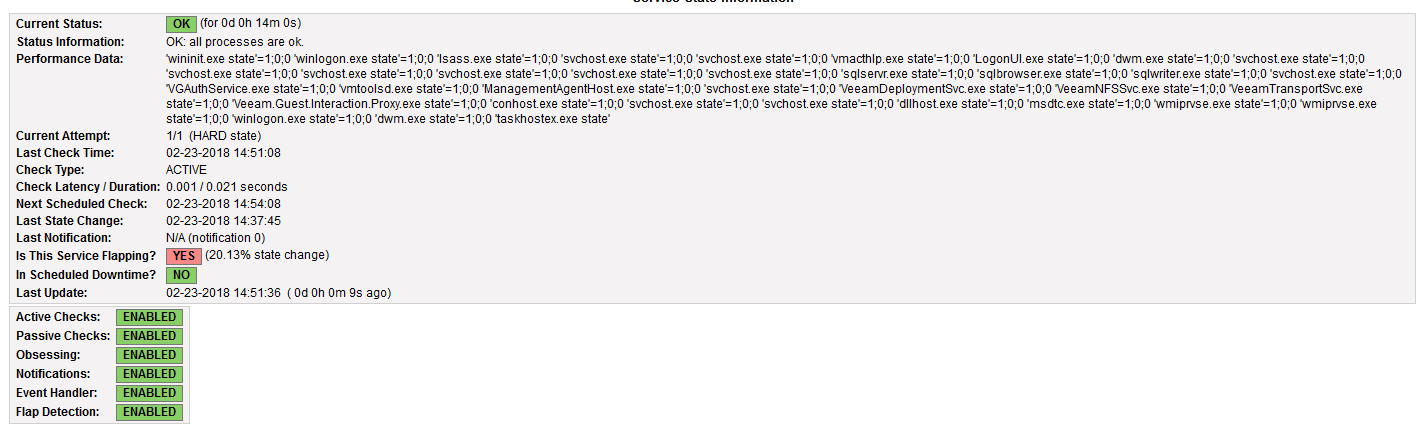

Using NRPE for windows server
Here you go also wanted to let you know it did not go into a critical state in nagios UI.

@skypete, If the service on the windows server has been stopped and you waited 20 minutes but Nagios still shows that the process is running, then either your Nagios config is pointing to a wrong server or the process is still actually running. These are two scenarios I can think of.

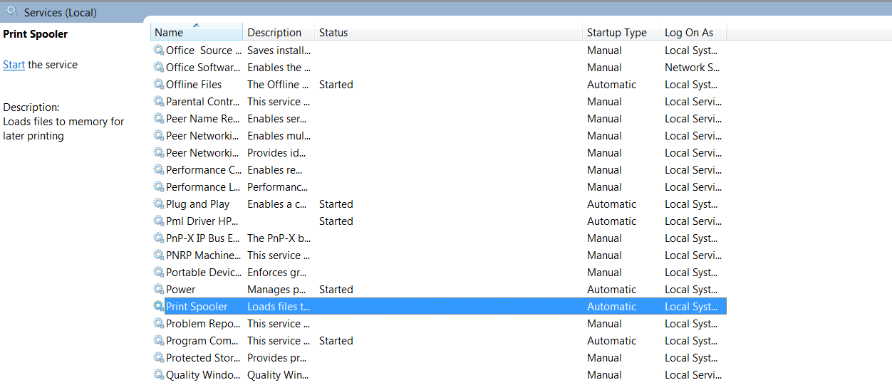

So, on the windows server please open the command line and run:
And take a screenshot.
Then, run:
net stop spooler
Then open the services menu and take a screenshot of the PrintSpooler process so that we can make sure that it stopped. Then wait 10 minutes and check the Nagios web interface to see if the service check is red.

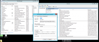

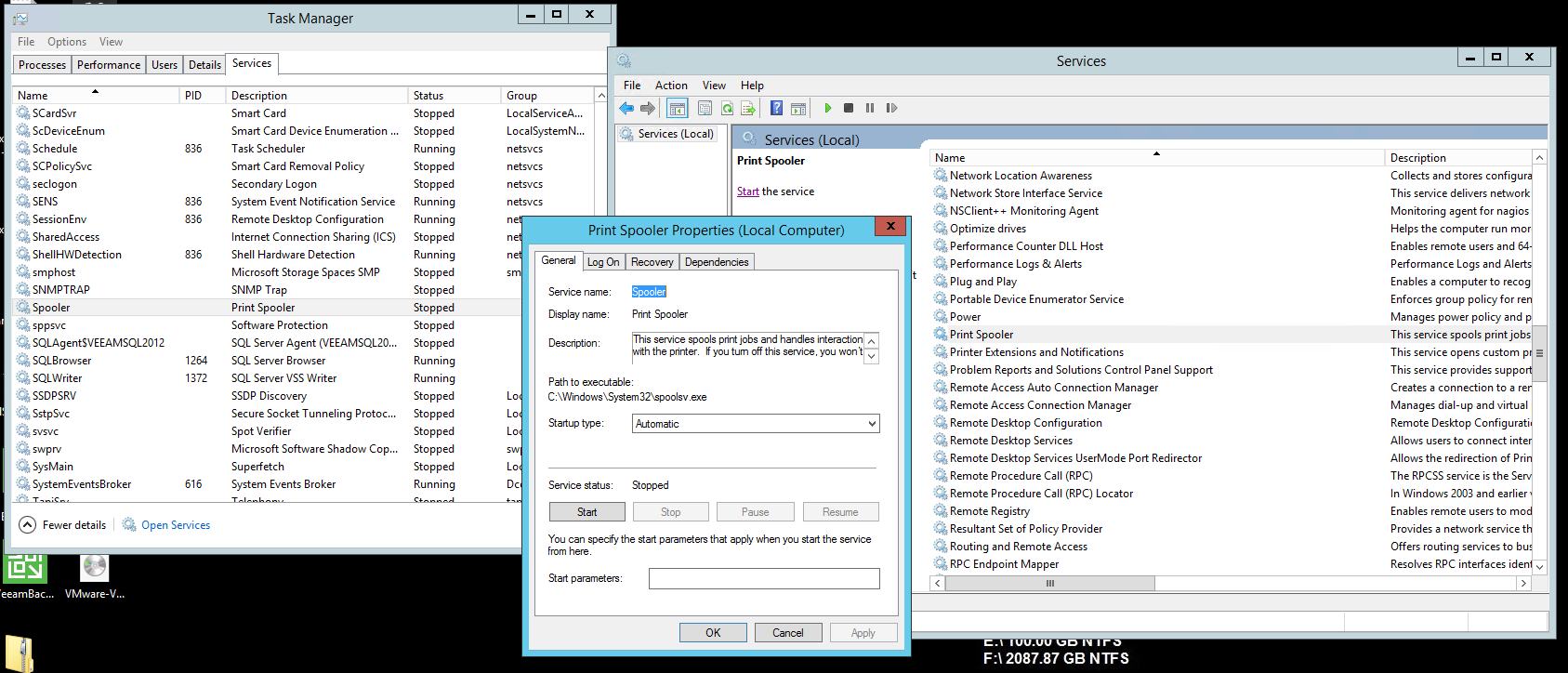

@skypete, Please stop the service one more time, then open the task manager in windows and make sure that there are no duplicate spooler processes running. After you made sure that the process is stopped go to the Nagios Core Web Interface, find the service check and click on Re-schedule the next check of this service. Wait a couple minutes and take a screenshot of the service state information page.
Also, you did not upload two screenshots that I asked for in the previous post.
I waited 30 min and restart the service from the nagios UI same result. Here are the screenshots you asked for thanks for your help.

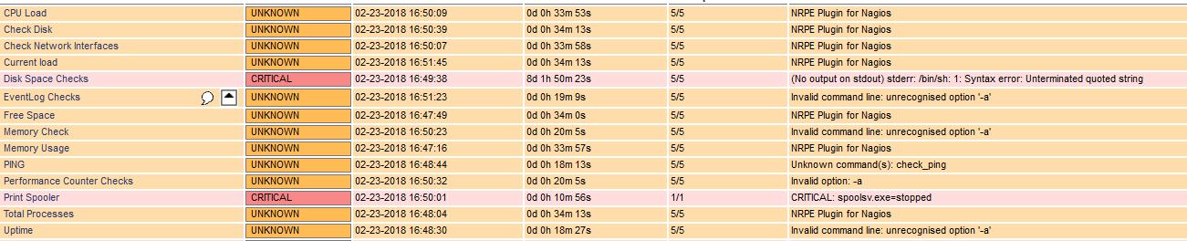

Hi the good news the spooler finally showed up as critical but no restart as of yet. All the other services are not working such as cpu load etc the are showing up as unknown here is a screen shot.
npolovenko
- Support Tech
- Posts: 3457
Hello, @skypete. Please change the nrpe command back to:
And change the service command to:
Then restart nagios:
That should fix all the other service checks and get the spooler one to work as well.
