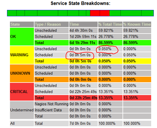

I found a bug in the availability report. The Warning percentages for scheduled and unscheduled are mixed up (see the attached screenshot).
I also attached the patch for the avail.cgi. Unfortunately I only have access to version 3.1.0 but the bug is present in all versions as far as I found. It should be trivial to implement.

Thank you for bringing this to our attention, would it be possible for you to copy your message here and post the bug report to our tracker system for the dev's?
http://tracker.nagios.org/
Thanks mikcik!
