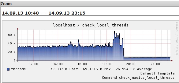

Okay - it finally happened again. The graph shows a spike of up to ~70k threads, but it's nowhere near the 140k kernel limit.
Might it still be the case? If not, any other ideas? I must admit I'm at a loss here.

This is strange, it seems that the total number of threads on your machine slowly but continually increases from 500-1000 to 35-40l, then starts severely spiking. I do note that there are a few times throughout the graph there are a couple other smaller spikes. Do you have an hourly or so cron job that might take about 15 minutes to complete? Also why don't you post your nagios.cfg and we can take a look to be sure nothing strange is configured there.
