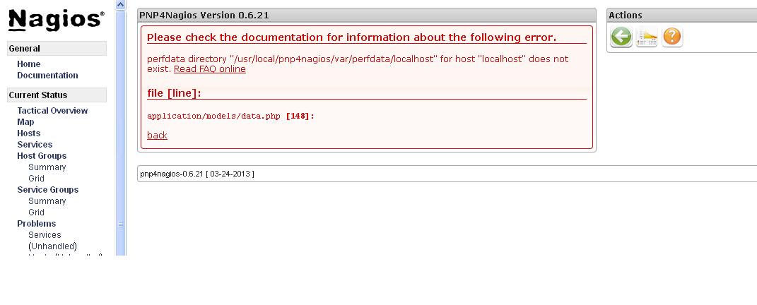

Re: PNP$NAGIOS
there is no RRD and XML files been created. when i run the "verify_pnp_config " i am getting the attached output. when i click on the pop up on the service i am getting the attached error "graph". Let me know what is going wrong here

Re: PNP$NAGIOS
Could you post your nagios.cfg file in code wraps. There are some notes that a npcdmod uses a broker, and not *_perfdata_file commands:
http://docs.pnp4nagios.org/pnp-0.6/conf ... nd_npcdmod
