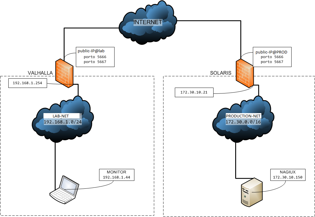

Problem is that part of the solution was to get the two instances in the same subnet. I'm positive that's not what caused the fixing, as that was achieved by correcting the configurations on both machines.
What's bothering me now is this question. Being the two instances on remote locations and different subnets (private addresses of one subnet make no sense on inside the other subnet and vice-versa) should I omit the address attribute of remote monitored hosts on the central server?
Thank you for replying and contributing.

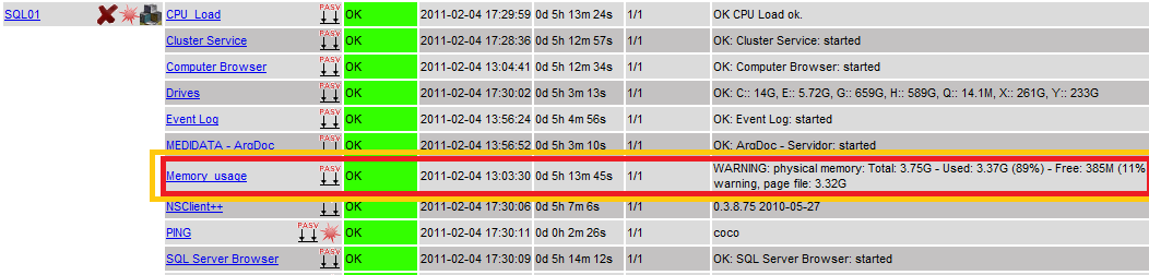

Thanks, all those problems have been solved, and fortunately, new ones have shown up.
Now, my central nagios server does not recognize some warning and critical passive service check results.
Additionally, the central nagios server is not getting the hostchecks from the majority of the remote monitored hosts (it's only getting those relative to the remote monitoring server plus one hostgroup) and I can't seem to find a cause analyzing the several .cfg files.

My guess is that your checks are all sending a "0" return code for everything, which Nagios reads as UP, or OK. See the following:
Host passive string:
MyPassiveMachine;0;'Host is up'"
<hostname> ; <state code(0-2 for hosts, 0-3 for services)>; <message or output>
Service passive string
MyPassiveMachine;PROC;0;`$LIB/check_procs`" -> At the moment, this is setup to always send an OK result
<hostname> ; <servicename> ; <state code> ; <message or plugin output>
NRPE is a little bit nicer in that the check results are interpreted for you.
